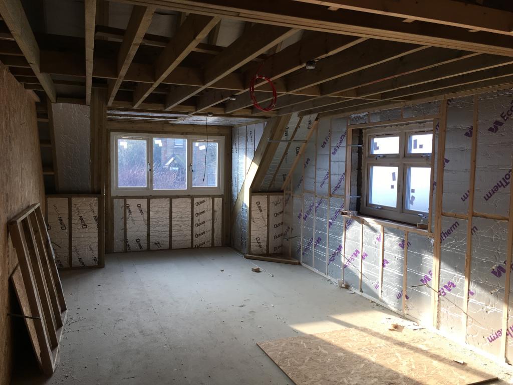

You could also consider insulation of the walls and ceiling if you have the room to fit it in.
A room with well insulated walls will up the comfort level even with a minimal amount of heat.
Also it will reduce condensation on metal as the space cools down as the cooling will be much slower and should retain some warmth for a considerable time, drafts permitting.
You need to build a stud wall inside the outside wall and fill between the studs (2 x 2, 3 x 2 or even 4 x 2 inches) with good insulation.
Here is Blighty we use 'Celotex' or 'Kingspan' it is easy to cut etc.
It's made of this stuff...   https://en.wikipedia.org/wiki/Polyisocyanurate
Then screw 1/2 or 3/4 ply to the studs (we use oriented strand board its cheaper but rougher, known here as OSB) and you will need far less heat.
Make up something similar for the ceiling.
Then you can move in!
Ps If its a posh job you would include a vapour barrier under the ply.
Cheers
micm (Architect)
