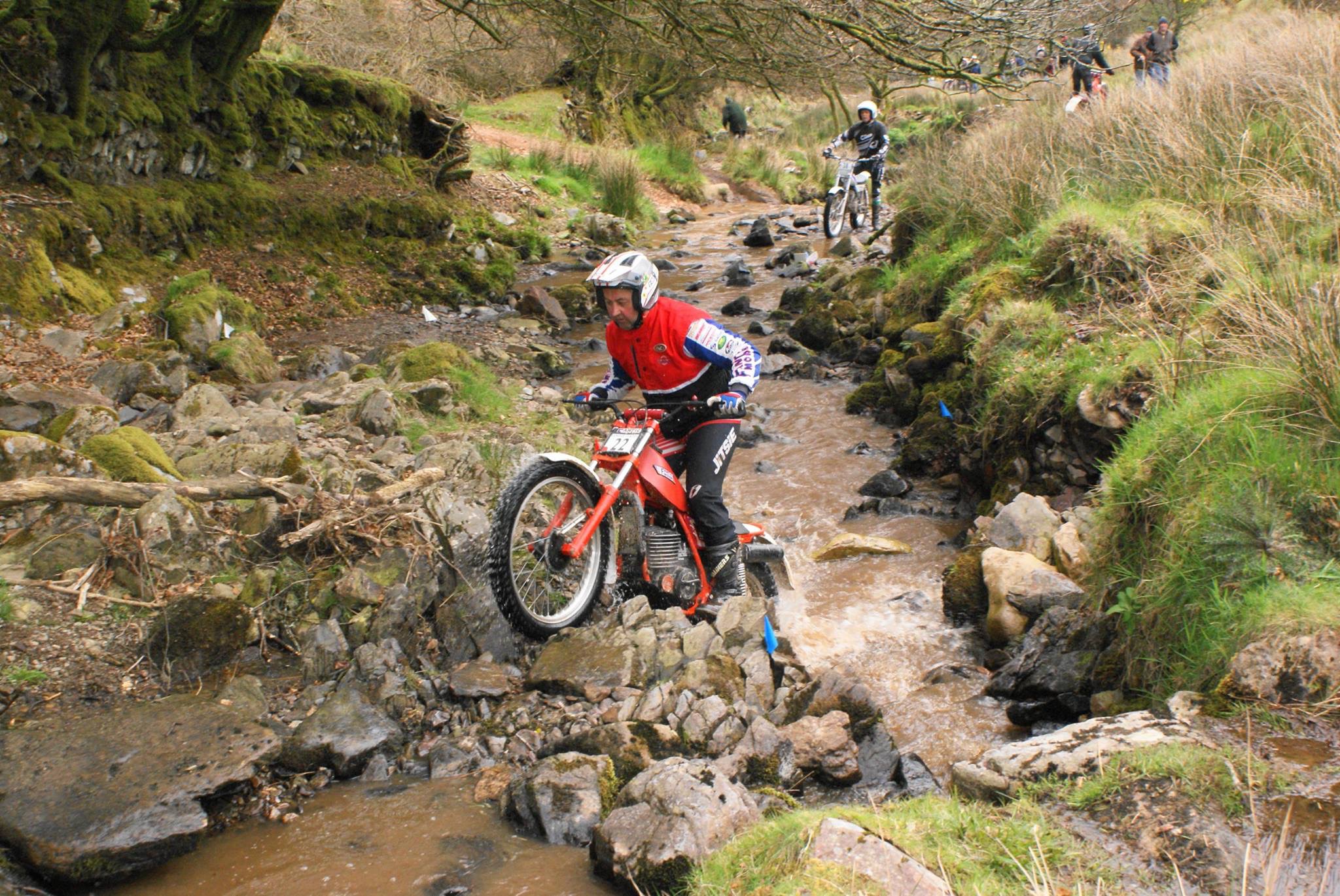

Here is a 340 from me. 262 cc with offset ground crank pin giving 2 mm longer stroke. Base engine was 303. Sadly taken from me by a snake with a handbag....
steeper head angle, 300 airbox, exhaust, silencer, keihin pwk 28, 300 forks, 300 frt brake. Longer shocks give a bit more ground clearance, the 300 shocks are also 12 mm longer if I remember.
Nice to ride....

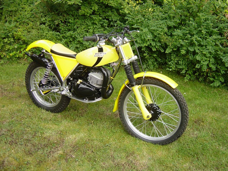

My last in period twin shock was a series 1 Beamish Suzuki (Silver Tank) a beautiful piece of kit, anyone know of a sensibly priced one up for grabs ? £3K on fleabay is a bit steep for me and yes I would keep it original.
Nice to ride....
That's definitely a bitza, it's also got the 300 swingarm plus other 300 stuff like exhaust, airbox etc but housed in the 240 frame. I don't get it. The 300 frame is strong and doesn't have under engine frame rails, so what is the love affair with the 240 frame?

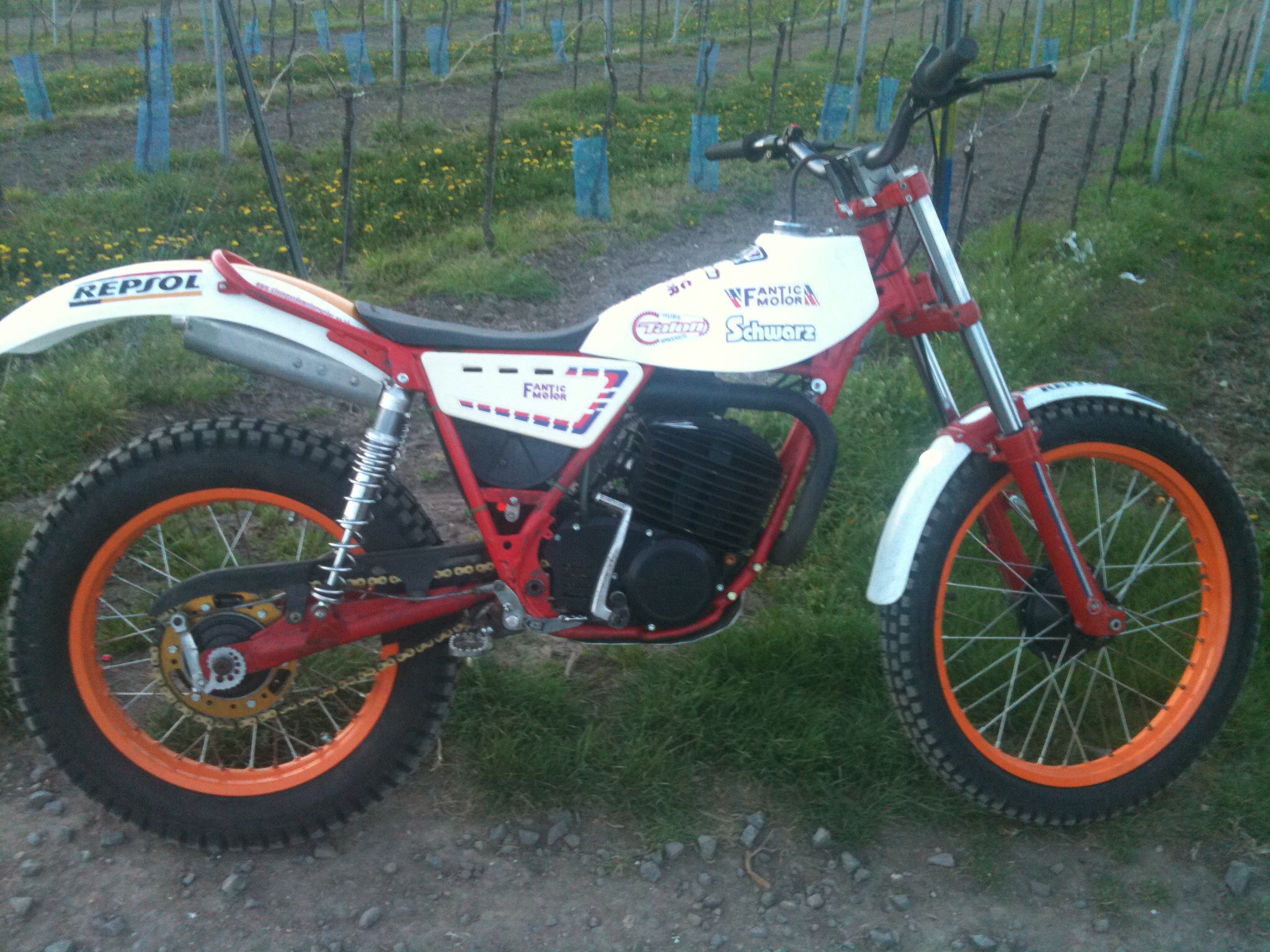

Whoever started this post/topic should be ashamed of himself, look what you have started!  In my opinion any of the twin shocks produced in the 2 years prior to their demise would be a good choice, but I do like the zippiness of a Fantic, it's the closest to a modern day bike if that's what one is looking for.
It's lighter?  Also, well done for winning the prize for not reading the post you're quoting ;)
Nothing wrong with some friendly debate about this sort of thing, better than sitting on your hands!
Apologies, it was Friday arvo when I posted and possibly too many "xxxx" bitters had been consumed. So getting back to the frames, is the 240 frame a better option due to it's lighter weight ?
All mine have a 240 swingarm, for what its worth...
the 300 and 240 weigh about the same...
i have 300s also... i just dont like the shocks digging in to my inner thigh..especially when I fall off...
as the people says..you pays ur money and takes ur choice
