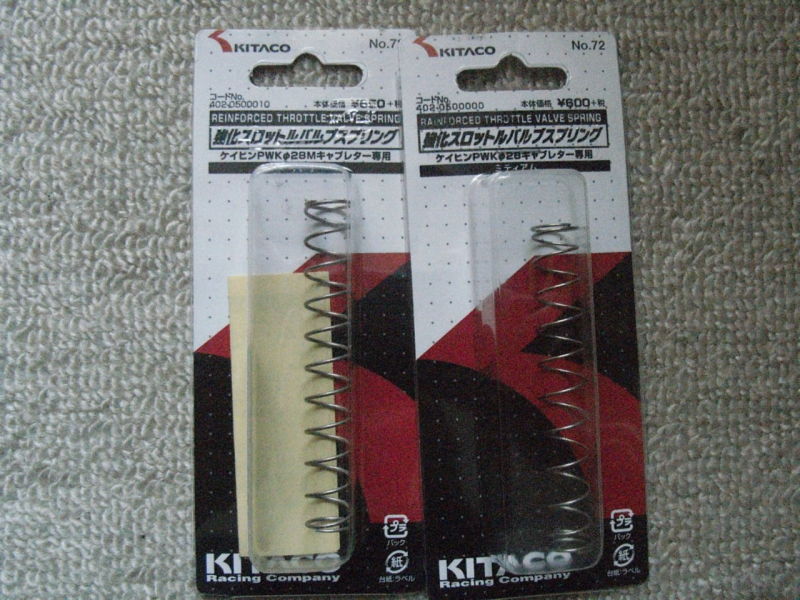

I've just moved onto a Sherco with Keihin PWK carb, from a GasGas with Dellorto.
I'm finding the throttle very light on the Keihin and a bit easy to wind on too far!
Does anyone know if there is a stiffer spring available? Or perhaps a spring that could be coerced to fit? I've had a search but not found anything that mentions being stiffer.
In reality I probably just need to get used to it, but I reckon I'll scare myself less with a throttle more suited to a heavy-handed user.

Mikegas - thanks for that lead on springs. Have you tried them out? Any comments on how much difference each makes? I expect the medium is all I'm after.

Apparently the OKO springs fit and are a bit stiffer, so a couple of options now.

If you get an OKO carb spring (they are a copy of the Keihin) they are significantly stiffer than the Keihin spring.  It's a good and easy conversion.

2 options I'll keep in mind:
Do nothing. Or try the oko spring in a month or so.
I'm sure this is just a personal preference thing, no right or wrong answer. For a few dollars it's no big deal to experiment anyway.
