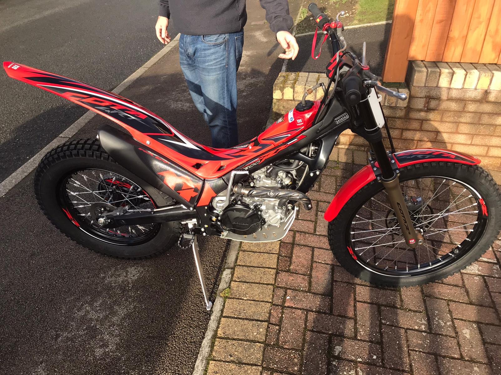

Hi all, I'm after advice, I have recently purchased a new trials bike. (Montesa Cota). I am after as much information as possible. I haven't ridden or owned a bike for over 20 years.. I'm 52 years old and my old bike was a montesa that I used to just have fun times on.. I never competed just rode with few friends on weekend.. after feeling I want to ride again.. I want to know what is the standard format after use to keep my new bike in great condition.. like cleaning lubricating all the important parts and with what products to use.. Any information will be beneficial as I'm not very mechanical, Thanks in advance.
