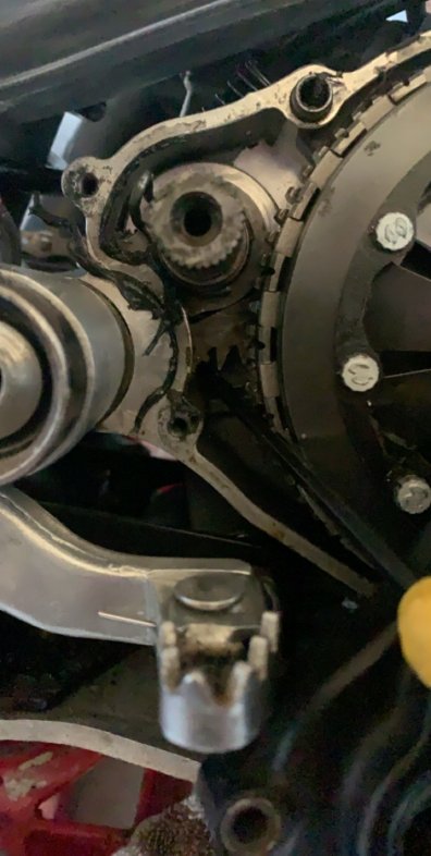

I’ve taken the cover off and found that the gear has snapped
Clutch comes off complete,one cap head Allen bolt in the centre holds it on shaft
not very confident but I’ll have a go at it tomorrow ?
Someone before me has had a go of removing the clutch and has rounded the head of the Allen key bolt ?
It is supposed to be a hallow bolt. So easy enough to drill the head off and remove the clutch. Then the bolt should come out fairly easily.
