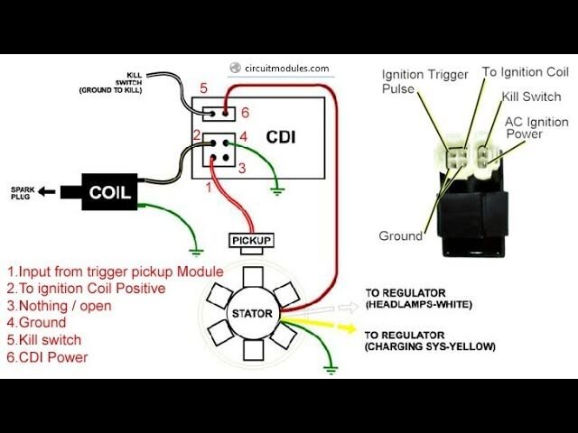

  4. Here is the generic wiring diagram that is the basis of my thought !!
  5. Hi There, I have done a bit more checking with my trusty multimeter. I have tested the resistance on the hall sensor/pick up coil. It measured 23,5 ohms. But what I do not understand is that I get this reading with one probe of my multimeter on the wire from the sensor and the other probe going to earth. Is this correct? In my simple brain the pulse from the sensor/coil will not go to the CDI, but straight to earth. I have also discovered that the damage to the lighting coil was done by my flywheel puller. Thks Bruce

  8. I assume it is running fine at Idle? What happens when you rev it out in Neutral? What happens when you try and rev out under load/in gear?

  11. Hi There, I did notice that , but there is no problem with the strength of the spark, it just seems to be firing at the incorrect time. This points me ( no pun intended ) towards the CDI or the Hall sensor. I think I have a long journey ahead. Chrs Bruce

  14. Looks like you have damage on the lighting coil?, potentially also damage to the ignition or pulse coil or even the damaged lighting coil is affecting the other coils. Have you got the resistance values for the various coils?
