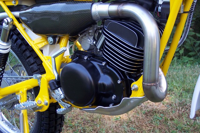

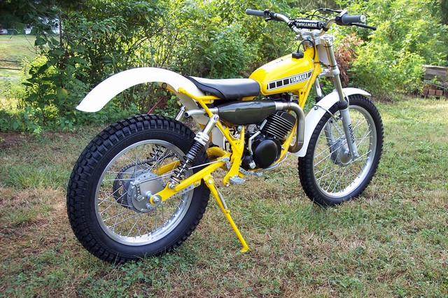

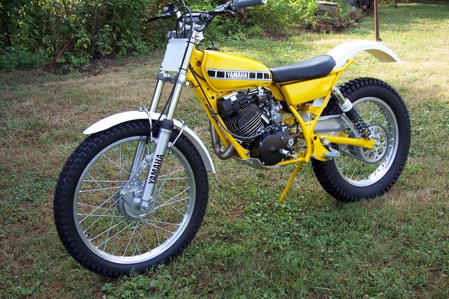

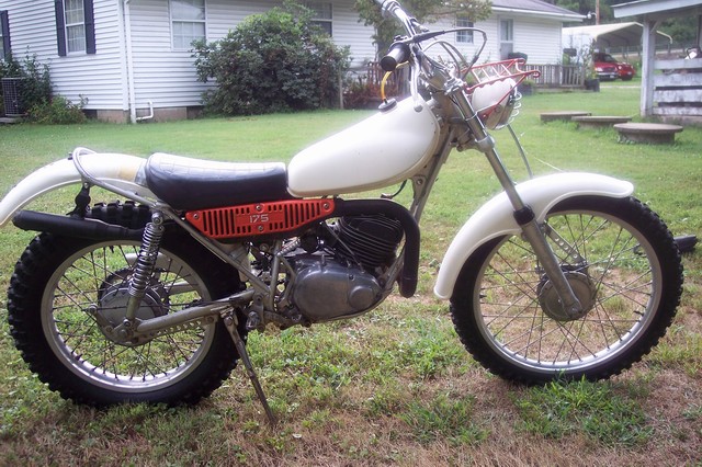

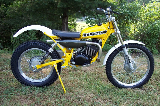

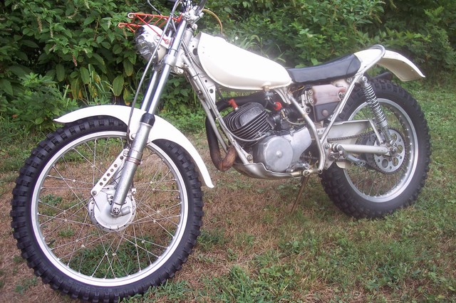

I bought this bike about a year ago to ride in Trials competition. Instead of just restoring it back to original condition, I wanted something that looked a little different, and this is my end result. I haven't touched the wheels yet, but I think I'm going to polish the hubs, anodize the rims black, and lace them up with stainless spokes and nipples.

I've seen a TY not too long ago on the web ( it might have been at www.thetwinshockshop.co.uk ) that had black rims. Makes the bike look much more modern. Cutting the rear frame loop off was a mod that quite few Hondas had in the '80s too. Lay-down shock looks good but suspect that you might end up needing to brace the frame around the upper mount. Nice to see 'something a little different' other than restoring it back to original condition.

Nice nice bit of work. I like the ty80 tank and the yz side case. How is it to start with the cut down kicker?

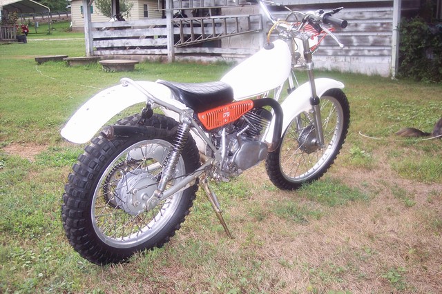

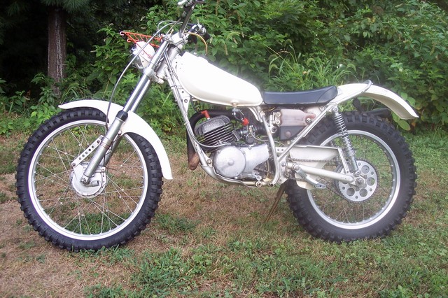

Very nice, are the photos before & after or 2 different bikes
I notice you are running a boost bottle, what is the manifold off?
How much did you lengthen the swingarm by?
The tank is actually from a '74 Honda XL70 (I hope that Gremlins don't get me for putting Honda parts on my Yamaha). I had to move both the front and rear mounts on the frame to get it to fit. I really like the looks of it, so it was worth the extra work.
The bike has a B&J Racing electronic ignition on it, and it starts really easy, so the shorter kicker is no problem. I still have to lift the footpeg up to get it to kick all the way through. Since it's shorter, it's less likely to bend like the original one did. The lower half is the original TY, and the upper half is from a '91 Yamaha WR200. The detent ball and spring was in a different location on the WR kicker than on the TY kicker, so to get it to work, I had to drill another pocket in the TY lower half for the ball to detent in to.

These are before and after photos of the same bike.
I extended the swingarm by 50mm.
The manifold is from a Yamaha RD350. The bolt hole pattern is the same, but the RD manifold has a couple of "ears" that have to be trimmed off before it will bolt up against the TY reed cage.

Very nice bike. Mate you have to put a brace to the shock mounts before you take it out, it will crack otherwise.... take a look, the shock will be putting a huge side load on the tube.

how does it ride with the shocks laid like that, i modded a ty frame but didnt lean them that much
