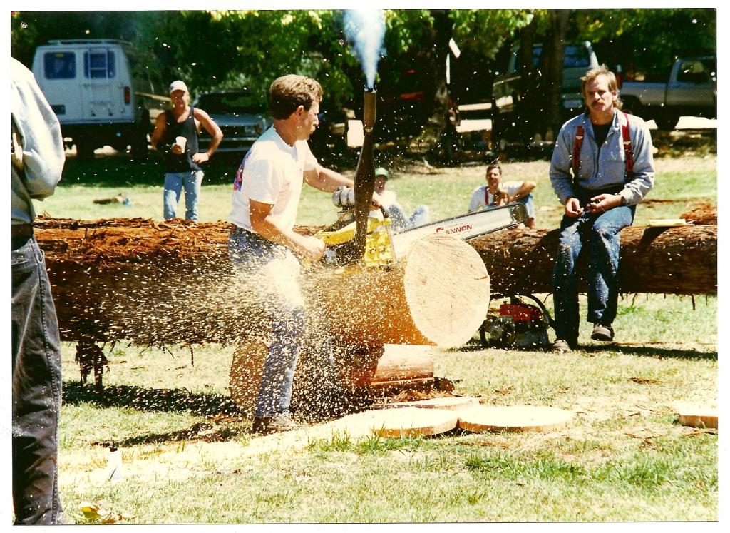

Oh, and sometimes you just have to guess what ratio to run: one of the competition chainsaws I built for my Brother. Twin pumper carbs, welded cylinder for large ports, tuned expansion chamber and a very healthy dose of Nitromethane......(20:1 worked well).
Jon
ps. I thought we were getting a little too serious.....:)

You need 100:1 in that chainsaw to stop all that smoking. You should also pack the canister with concrete to stop it getting gummed up, and add weight to help the blade through :D
Kidding :)

Hey Jon ; Isn't your brother supposed to be wearing safety Glasses ???
How fast did it make that pass/cut ?

Safety glasses are for two eyed sissies!
Faster than a guy cutting a block of cheese after having his finger pulled.

Nice picture for as old as it is. Looks like that answer S/A is holding that thing back from really singing!

"Hey Jon ; Isn't your brother supposed to be wearing safety Glasses ???"........No problem, he's a Lumberjack and he's o.k.......
Not sure how long but it was good enough for a first place. As you can see, even with a temporary bog from the engine, it cuts
quite quick. I had run a load of Nitro in it and it was a tad too much. A "full load" of Nitromethane is usually between 87 and 92%,
more than that and you can't always light it off with any degree of certainty (learned that from the fuel dragsters). Percentage of
Nitromethane is determined by using a hydrometer and reading the specific gravity of the mixture.
