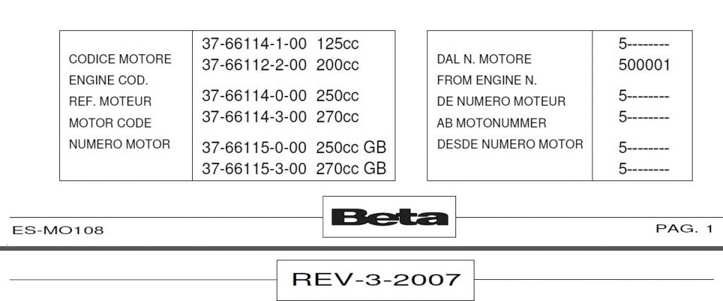

post-1592-0-82903400-1428526490_thumb.jpgthere is an obvious external casting difference between 125/200 and 250/270 cylinders. The header (exhaust) pipe on a 125 is also quite different to the 200/250/270. Should be easy enough to narrow it down just by looking at some close up photos of the engine or examine other bikes.
The engine/frame number series are also contained in the engine parts manual (attached). But this alone doesn't guarantee modifications haven't occurred.
