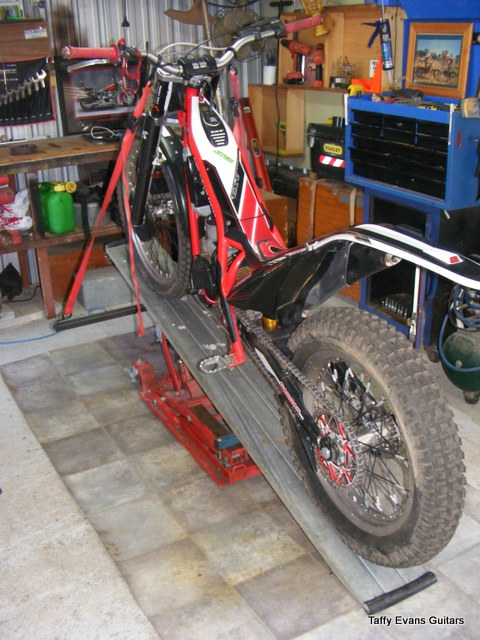

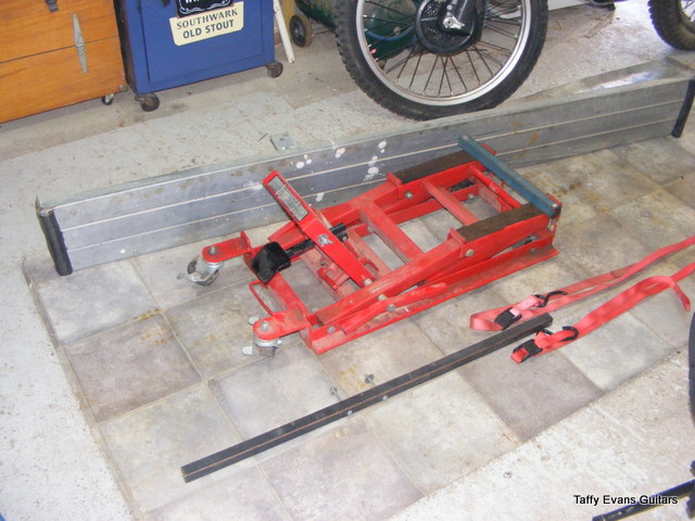

September 10, 201511 yr Hi all, just thought I'd show my modifications to my Harley bike lift jack stand so that is suits the Gasser. It should all make sense in the photo's. The ramp is fixed at the front and goes the floor at the back, wheel the bike on, secure it to the tie down straps, chock the rear wheal and pump away with a foot [any foot] and up goes the back end. Gets the bike up to a good workable height. Cheers Taff

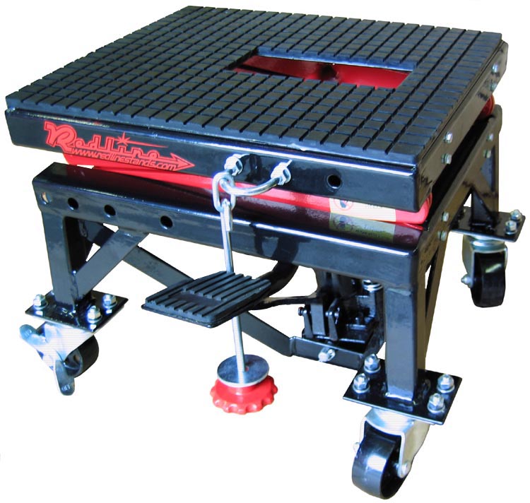

September 10, 201511 yr I would advise to also make a stand for the bash plate and add clamps to attach to your pegs. This is easy when you need to get the wheels out, front fork, linkagework etc. I got a mx lift like home build works perfectly. Also I can lay the bike down on it and pump it up for clutch work. Also maybe add a small tray for parts or tools. But nice work! Edited September 10, 201511 yr by crazybond700
September 10, 201511 yr Author Yes I have a smaller floor jack that I modified as you describe, pumps the bike up to get both wheels off the floor if needed.

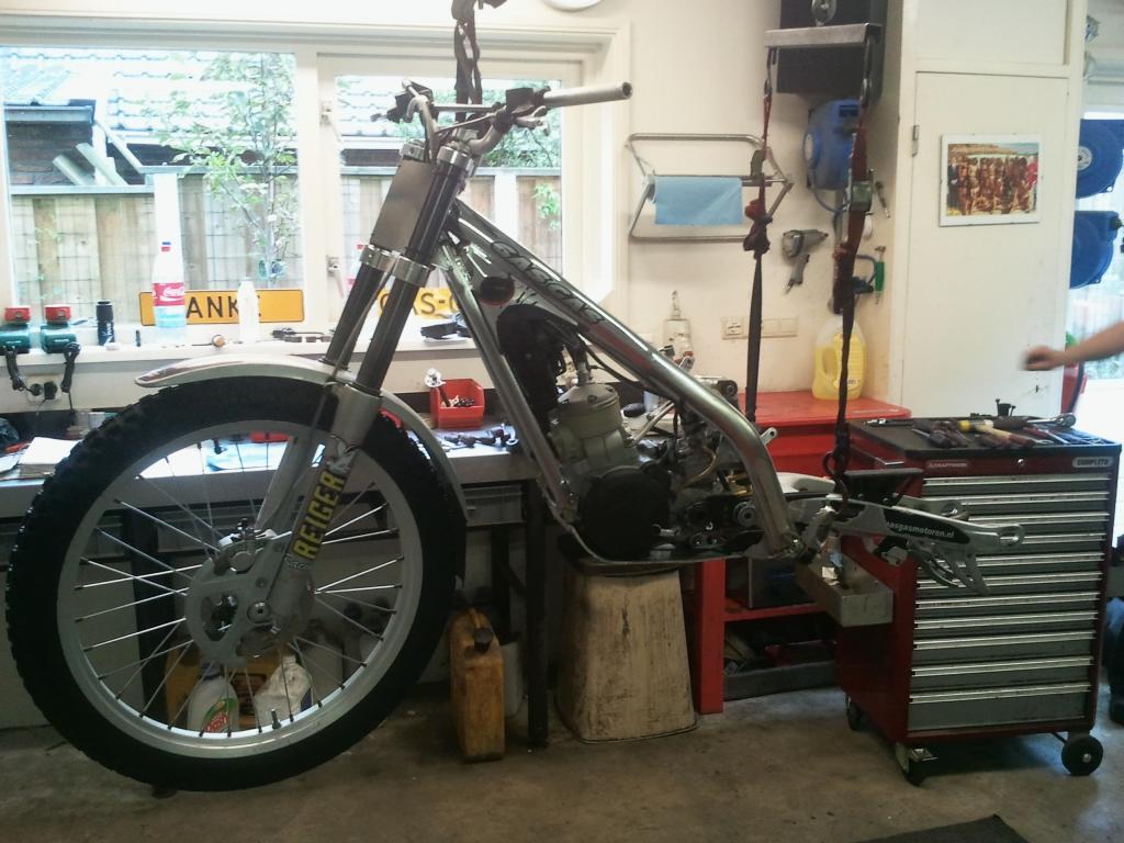

September 10, 201511 yr Another possibility, which is also really nice, is a cable hoist, which arent that expensive Really easy with letting oil of, work on bashplate, linksystem etc. Great musthaves for every mancave
September 10, 201511 yr Author Hmmmm, Crazybond I'd have to wear my helmet in the shed all the time with that hoist hanging from the roof. To justify the cost I'd need to see how many times I've needed to hang my bikes up to the roof to work on them. Well, in the last 55 years not once, so money saved there. Anyway I like to go down the DIY track first then the catalogue. Cheers Taff
September 10, 201511 yr Its a ''once you have it you never go without'' believe me! Edited September 10, 201511 yr by crazybond700

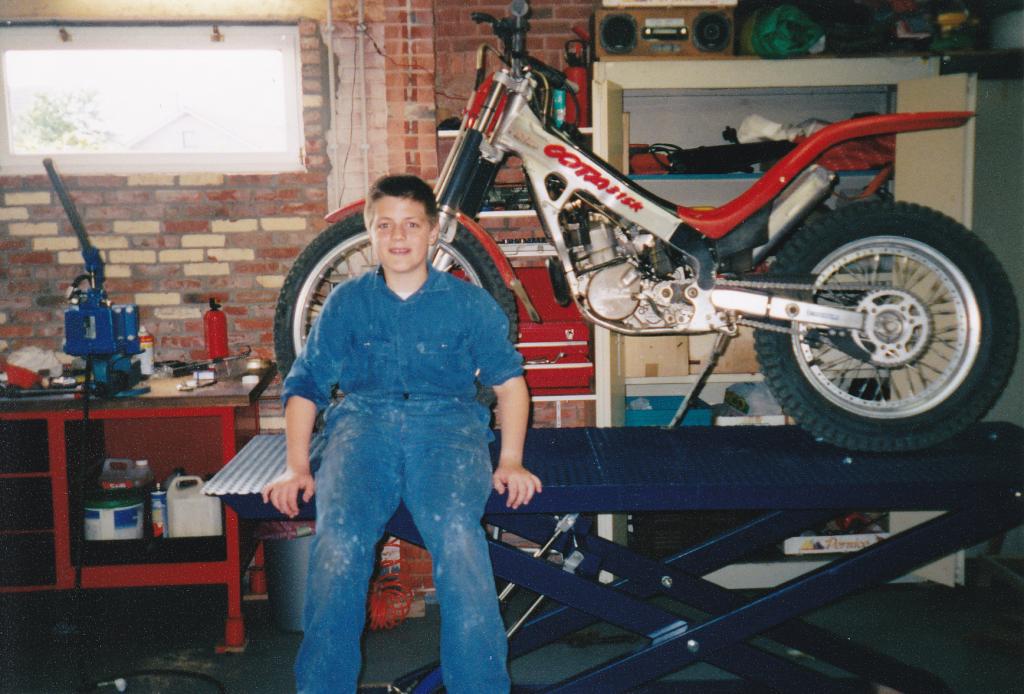

September 11, 201511 yr Crazy you and my boss enjoy a hanging bike. But it moves. Over 25 years ago I got lucky and bought a real motorcycle lift from a dealer going out of business. Nothing like being able to put four bikes cross wise to lift and change tires or forks all in one swoop. ( Ps Taffe`s idea is great!) https://www.youtube.com/watch?v=n7yHuPtsr8w
September 11, 201511 yr I think my tractor would fit on that It was actually made for my BMW road bike.
September 12, 201511 yr I think my tractor would fit on that It was actually made for my BMW road bike. Guys, I believe that is what dabster stated..................
