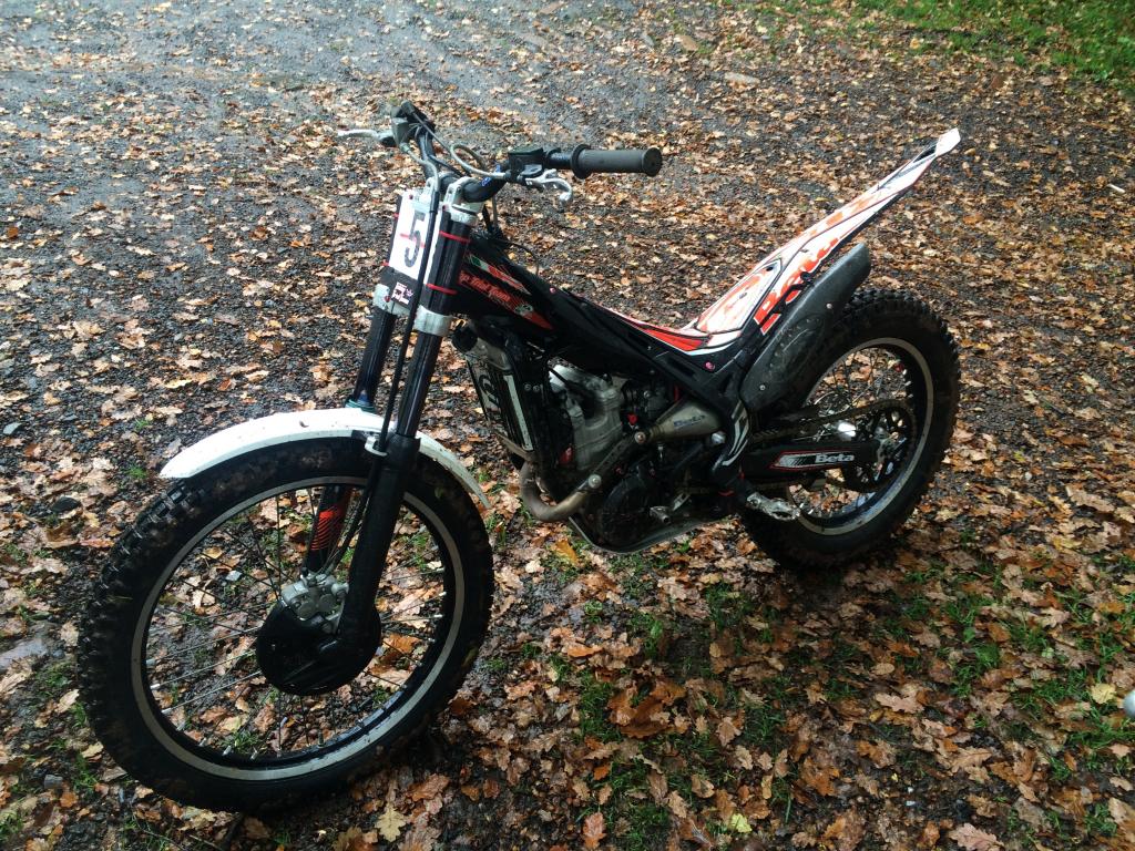

Flywheel weight or lack of makes the 4t's sensitive to throttle inputs compared with 2stroke equivalentpost-3832-0-25661000-1446245105_thumb.jpeg

Flywheel weight or lack of makes the 4t's sensitive to throttle inputs compared with 2stroke equivalent image.jpeg
Agreed
Touch the 4RT throttle & the FI is off like a scalded cat
