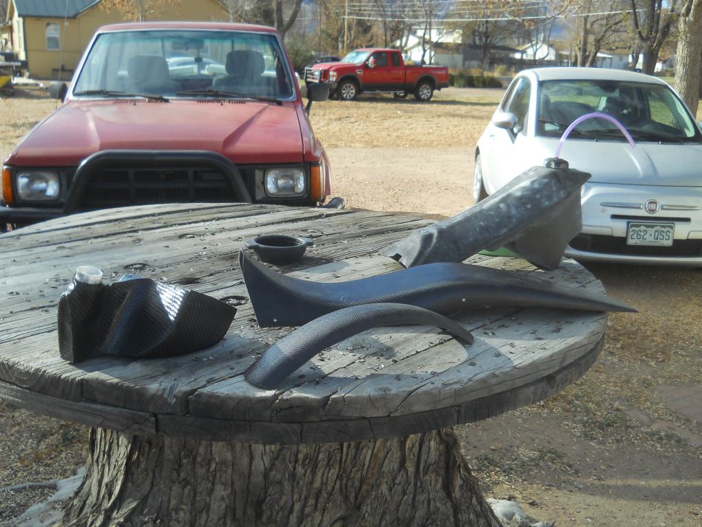

Been working on shaping the rear fender from pink insulation foam , layed up the glass and now have a mold , I did cut up the subframe ( it was bent anyway) and shaped the fender for a bit more modern look.

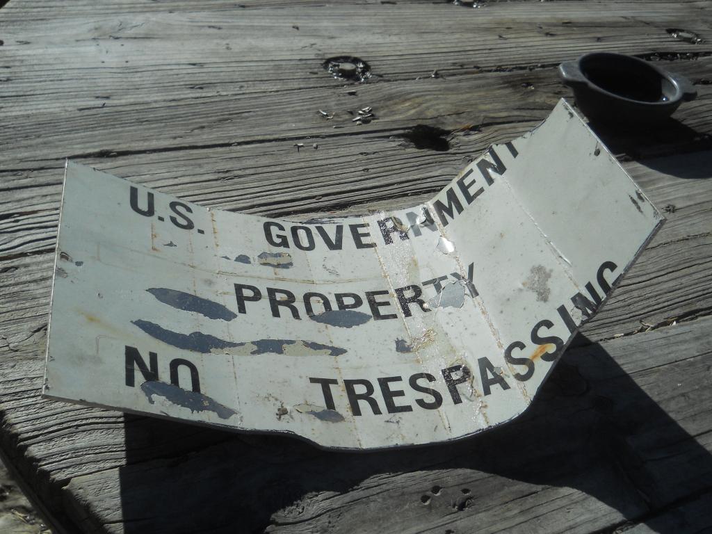

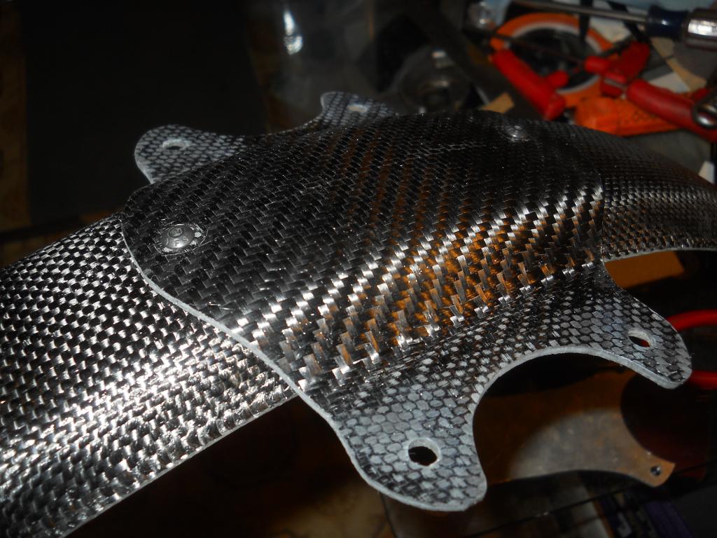

I've spent the past week or so working on fabricating the carbon fiber parts, the construction is finished ( except for the airbox and side plates which I'm still working on) , the final finish of all the parts will come after the rest of the bike is done , I also cut up and redesigned the exhaust and added a shortened FMF silencer from a KTM ( sounds great!, nice and quiet too ). Got the hydraulic clutch sorted out and it works awesome, easy one finger and predictable actuation .  found a piece of really tough aluminum for the skid plate compliments of the scrap pile at a decommissioned military base, not sure what the alloy is but it was hell to bend it into shape , took 2 people, 2 trucks and a railroad tie to get it done.

Looking very good, I love the skid plate that is brilliant!
What did you use for the carbon parts? Pre-preg, wet lay-up, RIM and what resin? Are you planning on lining it with an ethanol proof coating?
 I have alot of various types of carbon cloth left over from building Kiteboard hydrofoils and did hand layup for these parts since vacuum bagging these shapes would be complicated ( RIM would be even more complicated and I've not studied the process). the Epoxy resin I use is from "US Composites" and has served me well, it is also alot cheaper than "Resin Research" which would be my preferred epoxy otherwise, the only down side to US comp's epoxy is that it does not have UV inhibitors in it so will require painting, thats OK with me since natural carbon would really heat the fuel in the sun. Once its Post cured it should be resistant to ethanol but I am going to use " Red Kote" tank liner to be on the safe side, I've had good luck with that product in the past and have some on hand.

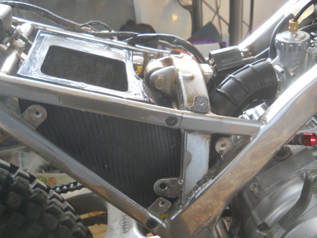

 Yesterday I finished the airbox construction , have to add a couple mounting lugs then it will be ready for sanding and finish.
Showing some great skills there ! Old government street signs ... Contractors overspending our tax dollars ... Decades ago I built a 2wd toyota pickup for desert use ,(long before "pre-runners" were cool :) ) And one evening out in the desert in the coachella valley we came across a big old Desert stop sign on a bent pole ...(6 foot octagon type ) and I thought HHMMMNNN.... skid plate ! It was 1/4 inch thick with 6061 painted in bands across the backside ... With the help of a large hydraulic sheet metal brake and some tall jackstands under a hoist ,  I ended up with a skid plate that went from the bottom leading edge of the frame back to the tailshaft and was bowed down on the sides a bit so the lower control arms just cleared it when topped out ...worked a treat !
Glenn
  (and I never did get all of the red & white STOP off the metal , but it was on the topside so you never saw it unless you looked under the hood past the engine :))
  OOPPS ! just re read this ! 1/8 thick not 1/4 !!!!
Edited by axulsuv
The underplate needs to be strong enough, not only for hitting purposes, but its also a part of the frame preventing the frame bends (too much).
 I think its strong enough but I'll give some thought to adding " wings" to the sides to stiffen it even more. the TTR 125 frame is prone to bending for that same reason ( Plastic skid plate and no cradle).

The finish on the parts looks very good considering how complex some of them are. I’ve not really ventured into tanks too much as we seem to have a much more limited selection of sealants this side of the pond.
If you can vacuum bag then you can do RIM. There are minor changes to the bagging process, a couple of extra bits are required and the resin is slightly different, thinner and longer pot life. Having said that personally for small volume parts I don't think it's worth bothering with it and it doesn't work so well with complex shapes.

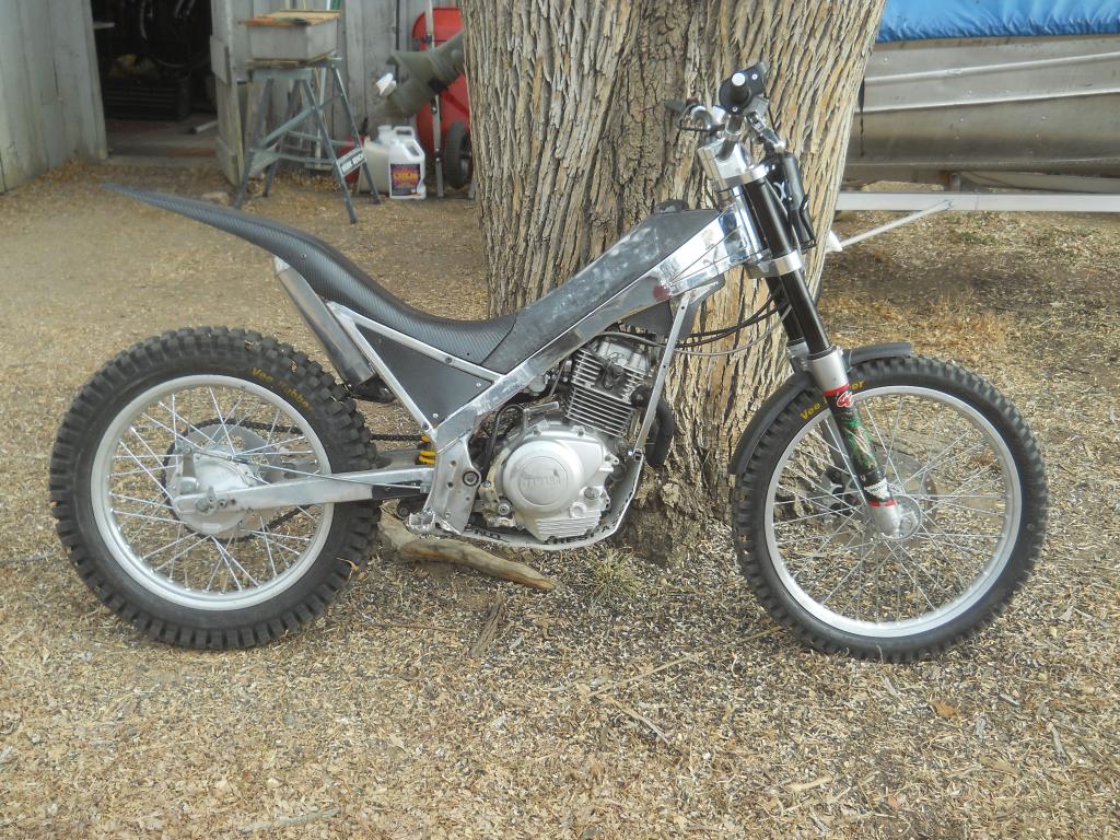

 Been working on adapting the TXT forks which turned in to more of a job than expected since I machined the frame's steering bearing pockets to accept larger OD bearings for the Beta forks, ended up having to press out the stems and swap the Beta stem into the TXT lower clamps, also had to start over with all the bushing and spacers for the front axle but what a difference these forks are over the Paoli USD forks , super rigid, Plush with no stiction  and the length is perfect, besides the bike really looks better in my eye with these forks. Also made a new temporary fuel tank , might even come in handy for future trail rides as spare fuel.  I had the swingarm axle slots extended forward 1 inch to bring the wheelbase to 51", changed the gearing to 11-60 which made a good difference and feels about right  but after riding a bit today I think I'll put the heavier flywheel back on(18oz heavier than this lightened flywheel) .

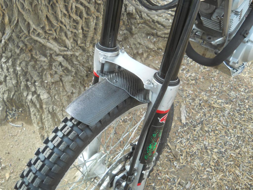

Made a carbon front fender mount and alum fork brace , kinda strange looking as it is 2 tiered but I think I like it and the added stiffness with the brace is substantial, laced up the aluminum front rim and mounted the trials tire , reworked the rear brake pedal to achieve a longer stroke with the kicker along with a bunch of other minor detail stuff.
 So its looking and riding like a trials bike now, ( at least to me) and I am close to the point of tearing it down, finish the welding and working on cosmetic stuff, sand blasting , sanding and painting as well as finish work on all the carbon parts, still havnt decided on a paint scheme, winter weather will determine when all that gets done.
 Pretty pleased so far :)
