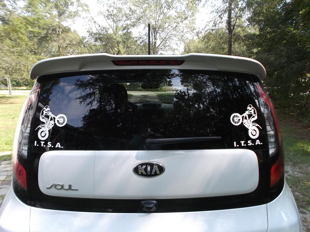

Yeah , stickers .... My new commuter ...
And yeah it's got a 2inch receiver trailer hitch on it already , just like my old Suzuki sx4 ...
I really can't complain about 30mpg with trailer and bike ...:)
