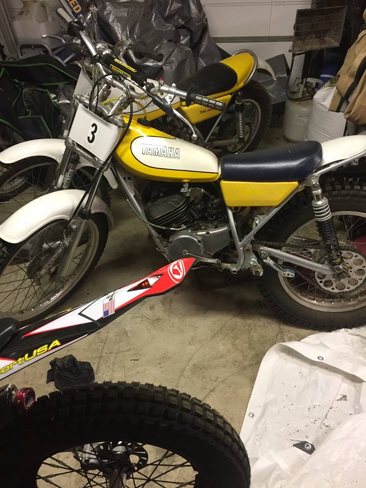

I ride a modern Trials bike and want to get a TY to ride and set up our vintage sections.

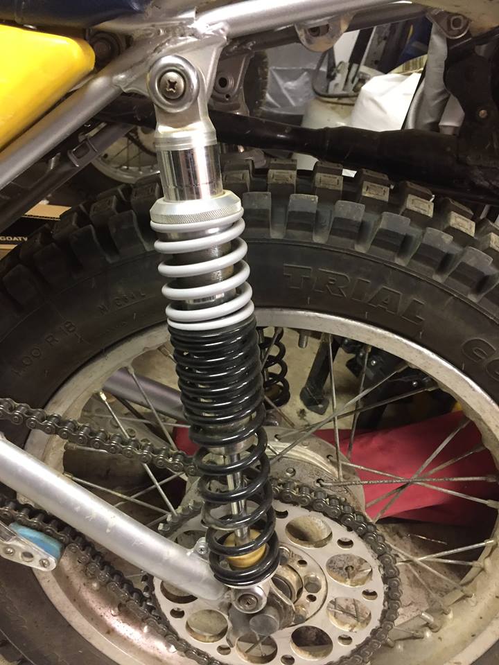

I found a 175 that has some mods done and looks pretty good. But the owner has a couple 250's that are not as nice. He put the 250 wheels and tires on the 175 because the tires where nice Michelin's and cut a spacer to line things up. This also means that it now has a dished sprocket on it.
My questions are things like, are they heavier ? will the dished sprockets get hard to get in the future ? Is this something anybody else has done.
I think it is silly he did it. maybe the spokes and rims are better or something else. but should I skip it or not be worried. I know the guy and he isn't a dummy. He says he can swap it back but I just don't know enough about the TY's. It has several other mods like the stiffer front springs in the forks and pegs done right. I am tall and it has the bar riser's.
Thanks for any input.
Hop
TY175 & 250 use the same wheels, there won't be a weight difference. The dished sprockets aren't the easiest to get but most places that deal with TYs can supply a spacer that lets you use flat sprockets
My biggest concern would be your comment about the spacer, sounds like the rear wheel will be off to the right side now
Personally I've always found the 175 to cramped for my height of 181cm which is part of the reason I ride a 250 even though most people say the 175 is the better trials bike
I haven't looked at the bike recently and not that close as we where riding together and I wasn't looking to buy.
The guy is smart enough to not have the wheel off center. I think he cut the spacer and moved it to the outside of the sprocket.
If a different spacers are available to be able to use a flat sprocket then that should ease my worries about future sprockets.
But I also am gathering that the brakes and cables should all be the same. I was thinking maybe the hub had a deeper hole for the brake shoes. I am going to go look at it in a couple days and want as much input as I want something that is hassle free.

The hubs are exactly the same on 175 and 250. The 250 uses a dished sprocket and the 175 uses a flat sprocket because their front sprockets are at different distances from the centreline.
A standard TY250 weighs about 11 kg more than a standard TY175 and 10 kg of that difference is the weight difference of the motors
