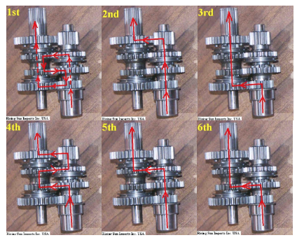

it is NORMAL.  years back there was a diagram showing why there is a bunch of resistance in the 4-5 shift, it is because rotation of shaft speed and the fact that it isn't at much about gears meshing, but "Dogs" on the side of the 2 gears having to engage.  As you have noticed the 1st 4 gears are just slighty different each shift, but the 4 to 5 is a big step, then 5 to 6 is less of a step, so there is less perceived meshing "noises" on the other shifts.
Hi Sting32 I think this is the image you may have been referencing.
It is a little inaccurate because it doesn't show the shift discs engaged in the correct positions, it just shows the drive sequence. You are correct - gears are always in constant mesh, it is the shift discs that are moving and creating the drive sequence.
But from memory the 4 to 5th change all 3 disc are moving and need to relocate into the appropriate gears, hence the 'tougher' shift in the Gasser boxes in some gears and not others. Some changes only one or two discs are moving.
It is a great gearbox design, just needs to be understood that you can't be hamfisted with it. Saying that a clunky change is understandable knowing the mechanics of it, but it shouldn't be 'grinding' - that sounds like big bits of metal are being turned into small bits of metal!
