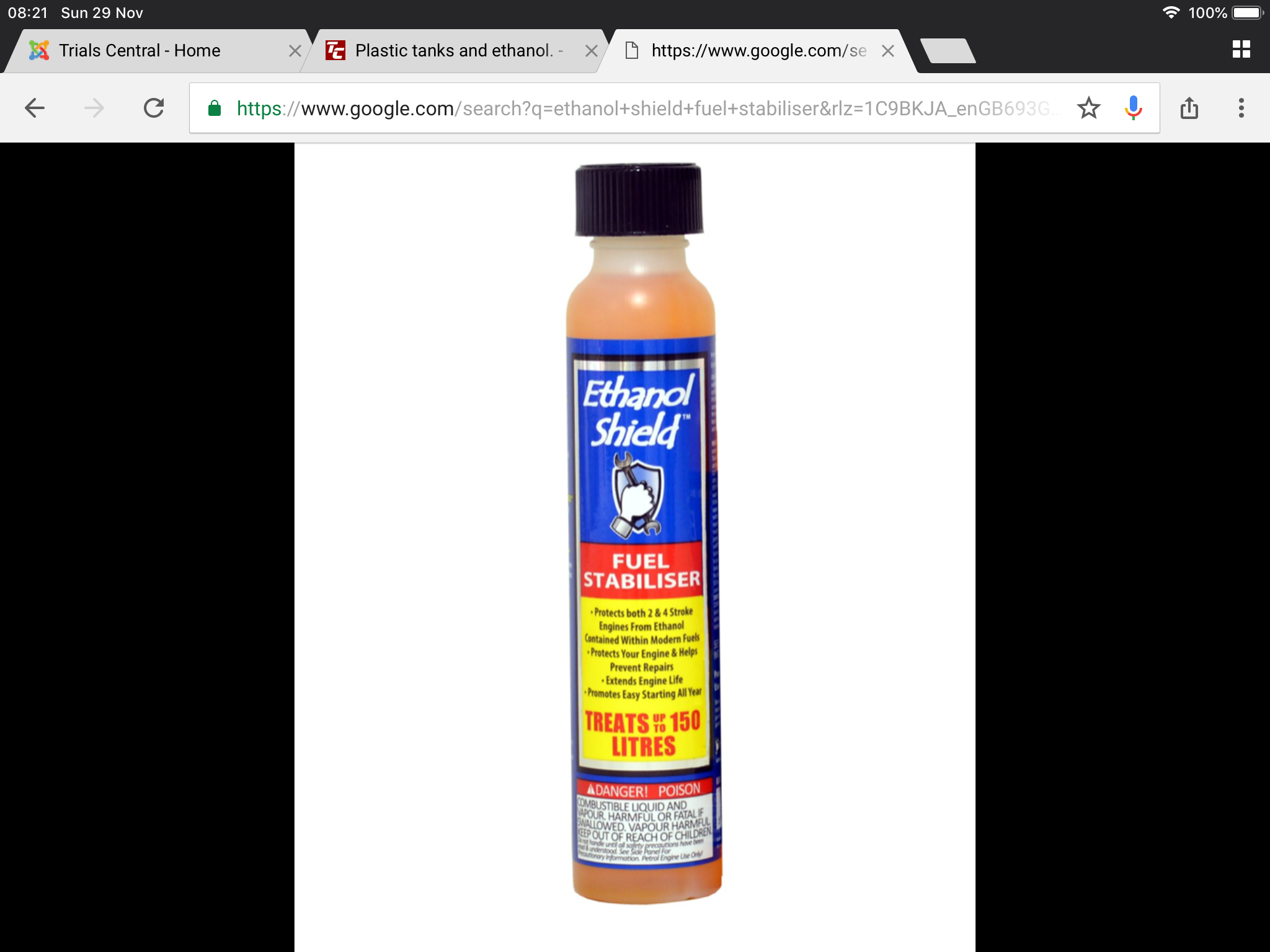

I use ethanol shield fuel stabiliser,  originally for small chainsaw engines it’s supposed to prolong the shelf life of petrol and prevent the corrosive effect of ethanol, stops it absorbing water. It’s relatively cheap, only needs tiny amount for 5l of petrol. I can leave petrol in chainsaw for months on end as it doesn’t get used much and it still starts and runs fine.
Meant to say I put it in fuel for 2T and 4T bikes too. No issues if a bike stands unused either.

So, it's a case of buying Shell ultimate or Esso synergy supreme plus. As long as you live in the right area. I've been putting "Briggs & Stratton Fuel Fit" in my mowers for a few years now. And also in my kawasaki W800 over winter. Maybe it's time to find an ethanol stabiliser to add to the fuel.
Never seen the ethonol stabiliser, good call, I'll have to get some....
