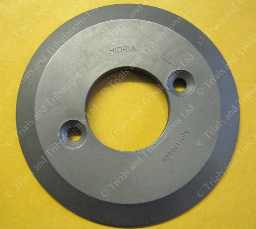

A flywheel weight really helps slow down the engine response.  I believe all UK bikes come with them but someone may have taken it off.  Pull the cover and take a look.  They look like the picture below and are mounted to the outside of the flywheel.  Also take a look at how many teeth are on your front sprocket.  It is counter intuitive but lower gearing (less teeth on the front) slows response by reducing the transition from clutch in to clutch out.  The bike will go slower in first gear.  Lower gearing also makes it harder for the bike to totally get away from you because it will run out of rpms before too long.  Many Betas come with an 11 tooth front.  I ended up with a 10 but a 9 is even better for the situation you describe.  A 9 kills come of the response to get over an obstacle but that may be exactly what you want plus you can always use 2nd gear.  Front sprockets are also cheap.  I also agree on comparison with another bike.

Yes, I have a flywheel weight fitted. Already checked that. I’ll check the sprockets though, thanks 👍
