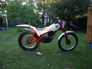

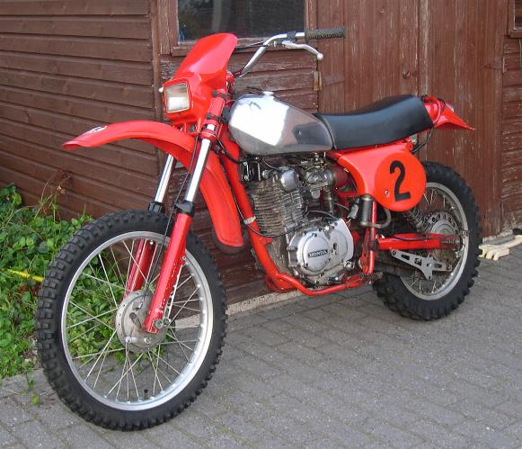

Here's both bikes we have which now have fourstroke motors slotted in place of the two stroke original.

    Here's both bikes we have which now have fourstroke motors slotted in place of the two stroke original. (i've a couple of honda motors on ebay if anybody's interested) Andy
