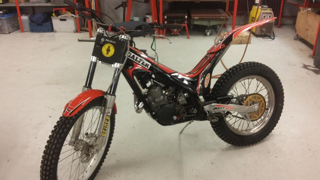

Had my first competition with the bike again and it all runs smooothly. Still some things on the list to do's though. (something with time and lack of it)

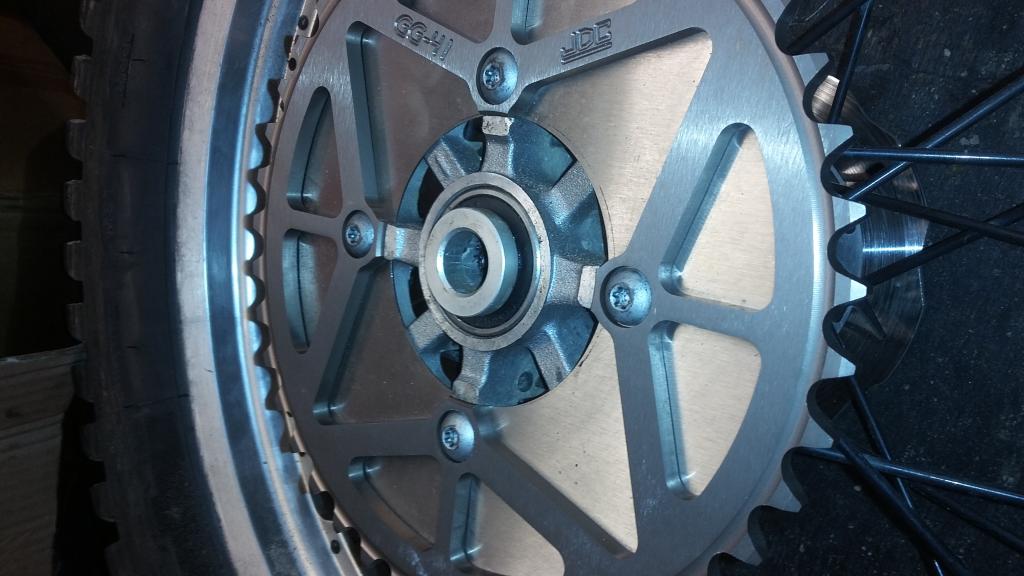

Also yesterday added new sprockets chain and wheel bearings.
Still to do:
Weld and paint frame (and add guards)
Put on new tanksticker and airbox side stickers
Rehaul front suspension
Edited by crazybond700
