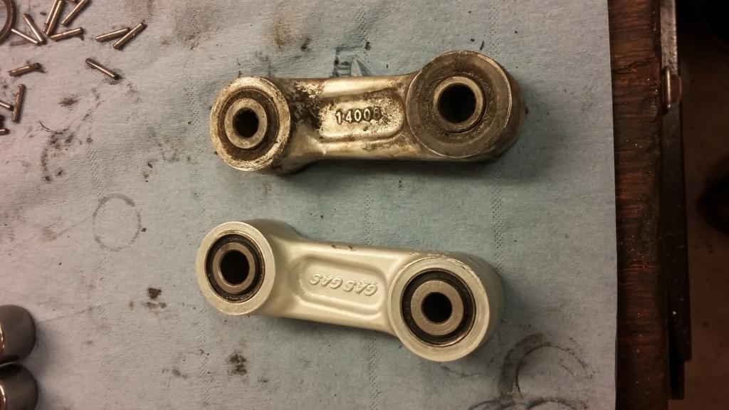

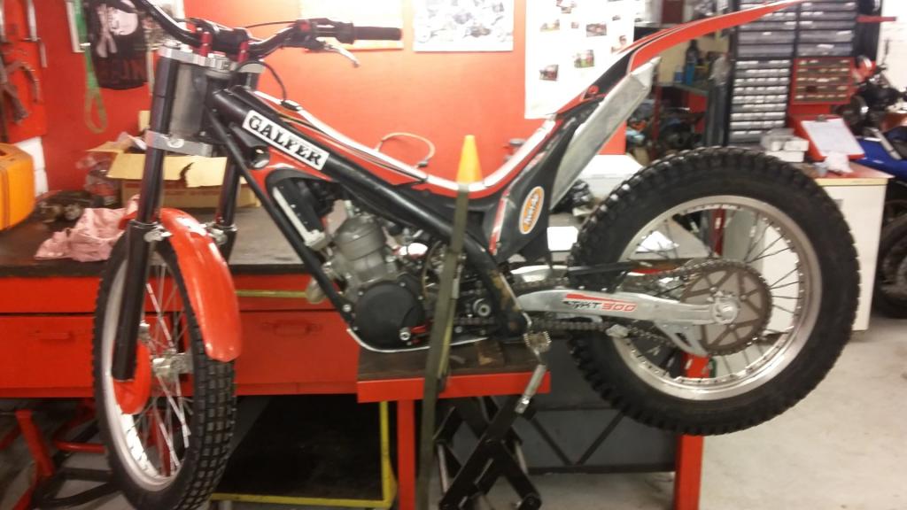

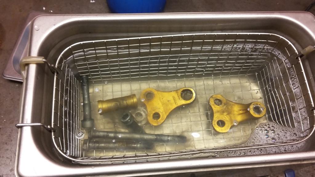

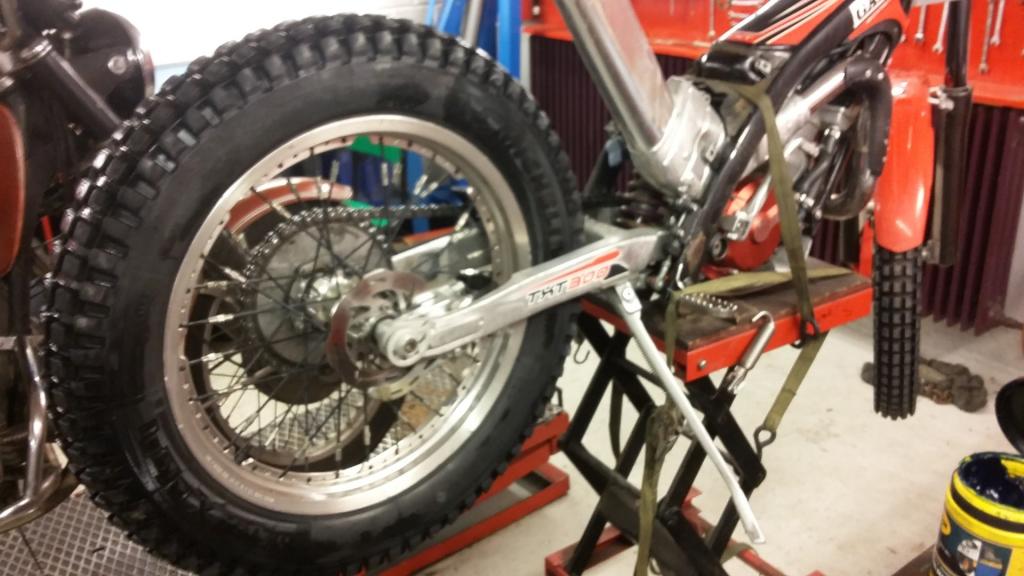

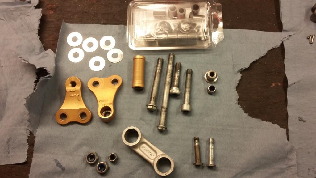

Did some work to my ''good'' bike:
New bearings in the link system.
Around check of the bike
Turned the rear tyre (it was already warm in the shet)
