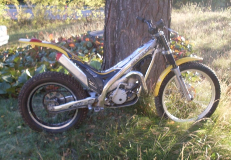

The leak is on my 2005 Gas Gas TXT 125 Pro i can off course take off the rim flap (see the red arrow on the drawing from the parts manual below) and clean the the "groove" in the rim where the rim flap sits and also clean the sides on the rear rim and hope that this will fix the leak
I suppose that this is the best way to fix the leak,
Never had any problem with the tires leaking air on my 2006 Gas Gas TXT 250 Pro and or my 1998 Gas Gas TX 321 Contact there are no problems with any leaks on the wheels at all
Edited by thesaint
