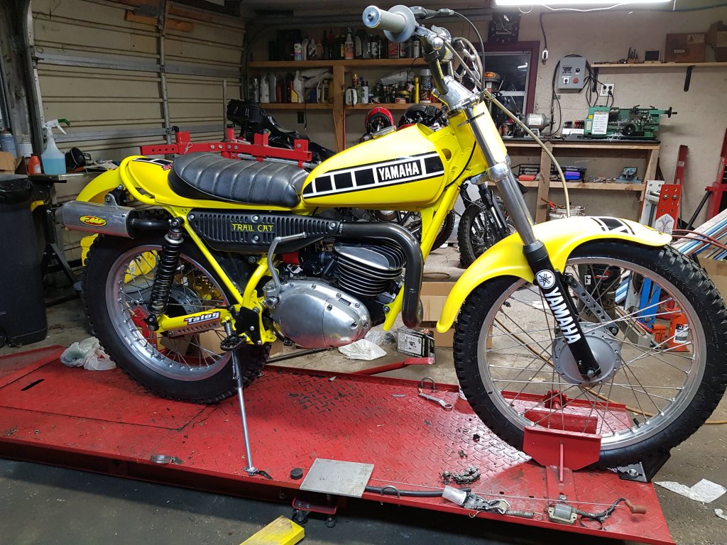

April 18, 20197 yr Author I need to plug some holes on the motor from removing oil injection. The flywheel cover and pump cover were damaged and welded badly so going to grind them out,reweld and clean up.

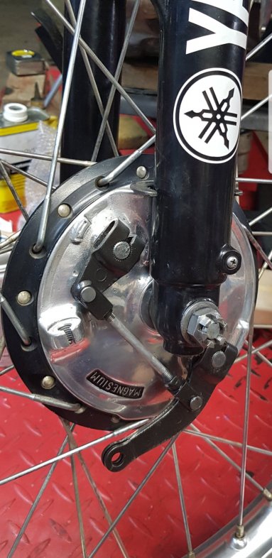

August 15, 20197 yr Author Been awhile since I posted here.Bike is running great and working on installing yz front brake as I tried everything with stock front brakes.I removed flywheel weight.I find I want some back so going to machine down 50% and put back on.me and a friend rebuilt our ty,s at same time but he used a wisco piston.His bike has some piston slap and my wossner does not.Have ran bike stock now and going to increase compression a bit.Looking to have just a tad more bite off the bottom but only want a little bit more.Bike starts 1st kick every time and is a blast to ride.Going to do 1 or 2 vintage meets with it next month. It is taking alot of dinking around to fit that front brake(77 TT500 wheel and 1980 brake plate).I hope it was worth it.
August 15, 20197 yr I have found the front brake on the Ty 250 more than adequate for classic sections, well maintained I really do not see the fascination with having to fit motocross brakes, are they really needed, more so for the feel good factor and nothing else.....
August 16, 20197 yr I fitted Yamaha DT/MX hubs to my Majesty, initially because they were the closest visually to Mick's works hubs at the time, but I was pleasantly surprised how much better the brakes were compared to the original hubs.

August 18, 20197 yr To use the DLS brake plate you really need to be using a 80/81 465 brake plate with mono forks otherwise the cable will be at a strange angle to the forks
August 18, 20197 yr 9 hours ago, metisse said: The hubs look great, but brake plates from " Scramblers " were not allowed or so I thought...if they had double cams.. or leading.. and can t remember the term.. Can someone with a better memory confirm whether that was true, still is, or in fact I had dream't it. Apologies, I should have made clear that the hubs I used were single cam, standard actuation
November 8, 20196 yr Author On 8/15/2019 at 2:39 AM, metisse said: I have found the front brake on the Ty 250 more than adequate for classic sections, well maintained I really do not see the fascination with having to fit motocross brakes, are they really needed, more so for the feel good factor and nothing else..... I fit them because the stock front brake sucked even after being reworked. I ride modern intermediate lines with bike that push the old girl pretty hard.I see no issues with making bike work better and even did it with period correct parts.Had nothing to do with any kind of feel good factor.
