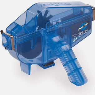

I've got a 3 sided brush from Halfords for the trials bike which seemed to do a half decent job, but it didn't come out as clean as my MTB chains do with the plastic Park Tool enclosure (pic below - too small for motorbikes).  I used a ton of rags on the trials bike in comparison to when I do the MTB.  Then again, it's a bigger chain isn't it.
