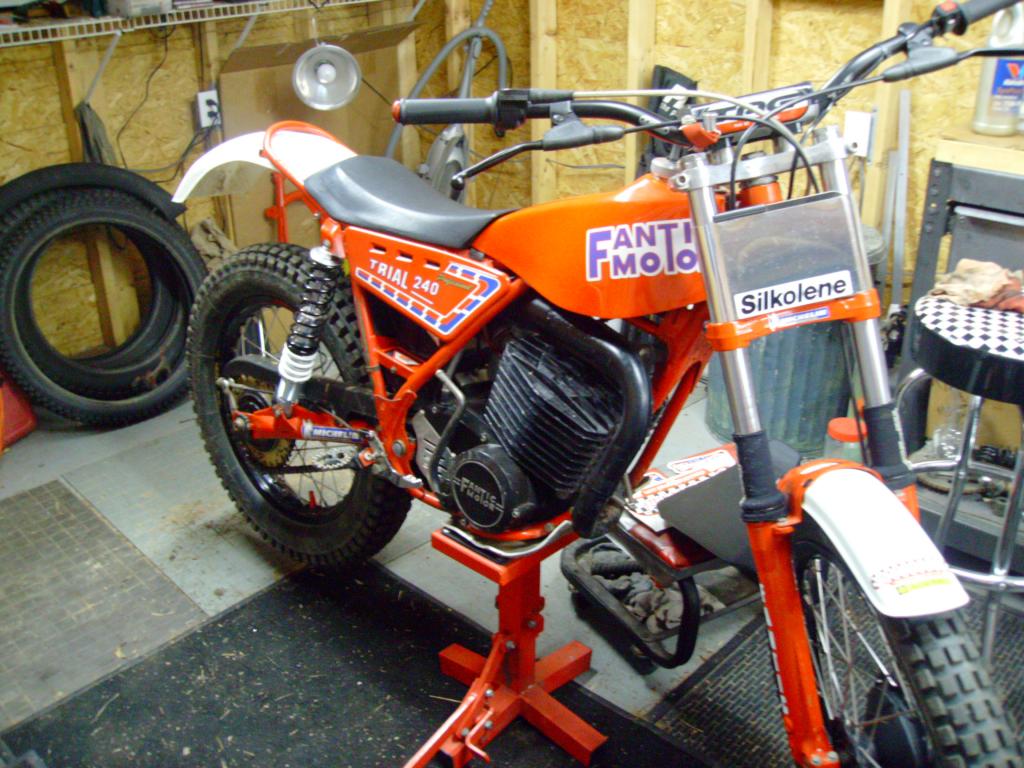

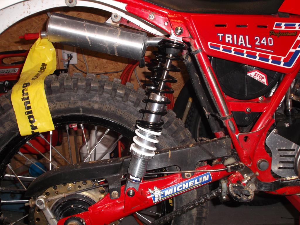

post-1232-0-75737300-1342905132_thumb.jpgNot as cool as Daves , but here's the old girl with new suspenders ...(and I need a better camera ...)
Glenn B)
And Keith , I'll see you at Lake Houser , so you can give her a romp ...:)
Edited by axulsuv
They are from Works Performance , alloy everything , gas charged , dual rate springs, 13mm shafts (HUGE!) and serviceable Heim Joints at both ends along with a offset top mount to clear everything ,14 5/8 eye to eye and I was told the dampening rate is Lane Levitts end result from his Bultaco days way back when ... Works sends you a Dimension/ layout sheet for oneoffs like these so they get the dimensions and leverage / angles that the shock will be used at along with all the involved weights .
They work Fantastic , No initial bind at all and on uphill muddy rooted stuff the back tire just stays planted , you don't feel any of the small stuff at all . unbelievable traction for a twinshock . Once I got the preload and sag set , it feels like a good modern mono now . and they are completely rebuildable with the correct tools and gas charging equipment . (that is all at my friends shop in NC.) And I didn't weigh them ,but I'd say their about 1/3 lighter than the falcons that came off .(and will get rebuilt one day and live on the FM330 or our overgrown TY80 ..)
Now if I can practice enough to use 1/2 my bikes potential , I'll be a happy camper !
Glenn

Hey,Thanks for being the test pilot for us Glenn,when I get over the Idea that my originals just need to be rebuilt one more time then I'll give Works a call! :icon_salut:
Didn't you really mean "crash test dummy " ???
Glenn

About how much are these Fantasmic shocks? lol
