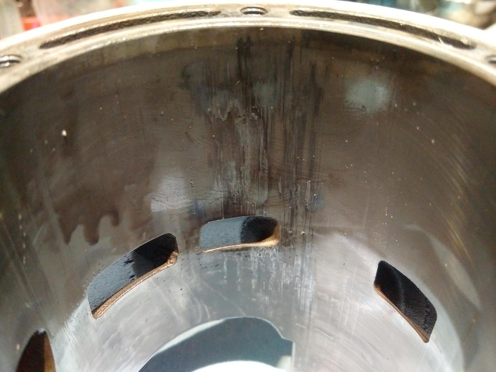

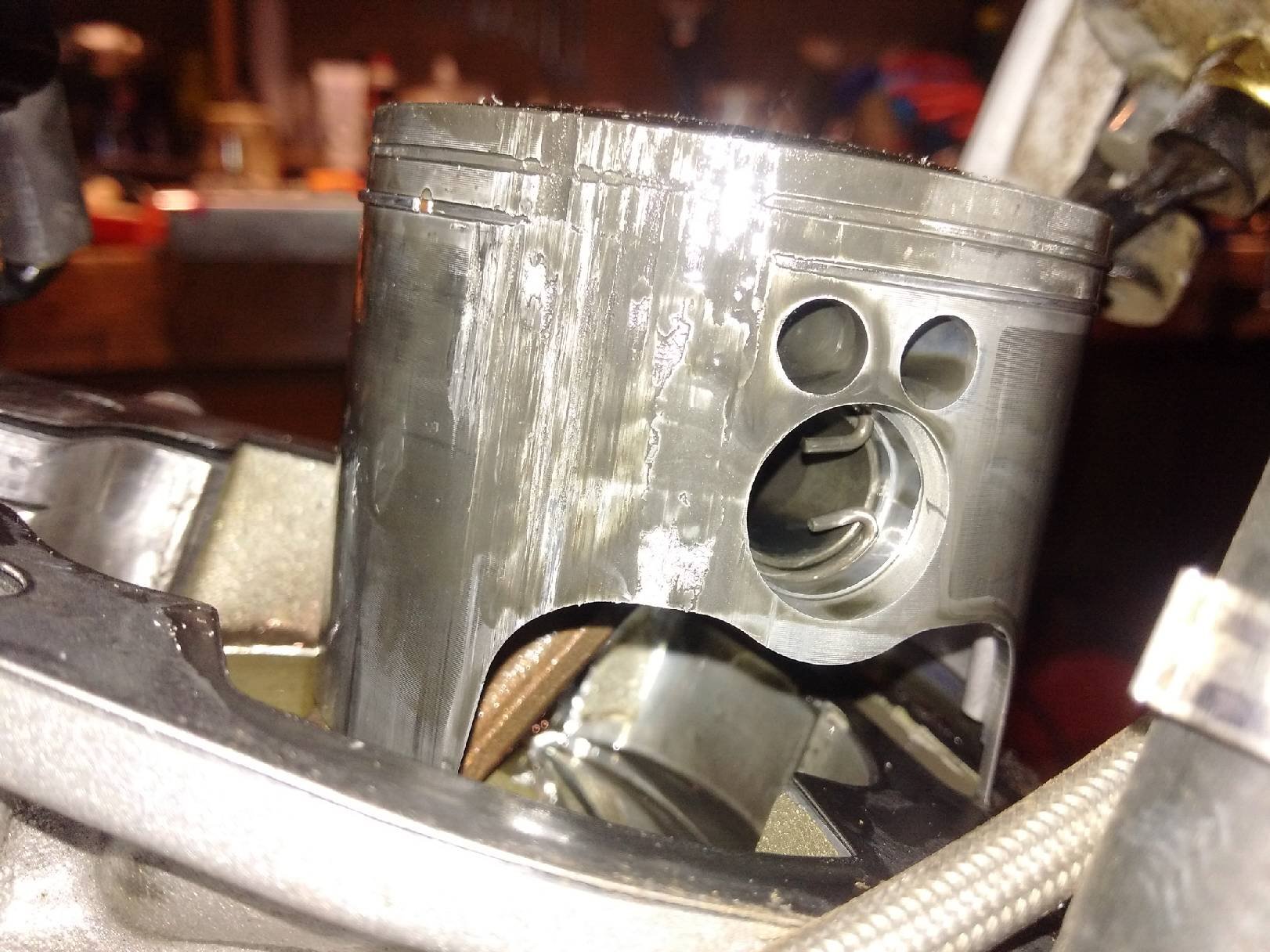

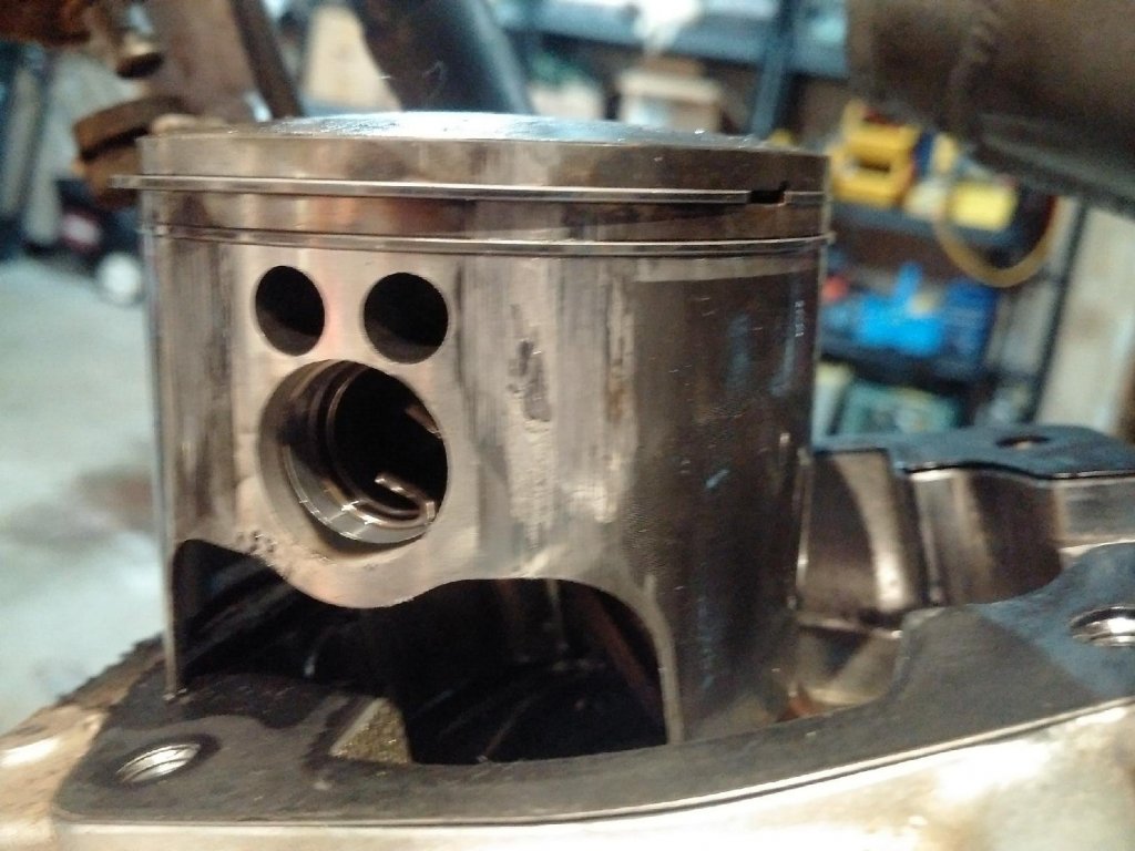

Yes, serious but sad post. An update on the bike.
Unfortunately the rings, piston, and cylinder wall got cooked. See pictures below.
Have to replace the piston, rings and get the cylinder rebored and plated. I'm not sure on the cost, and i won't get the cylinderback until early February...be careful about new years eve shenanigans.
