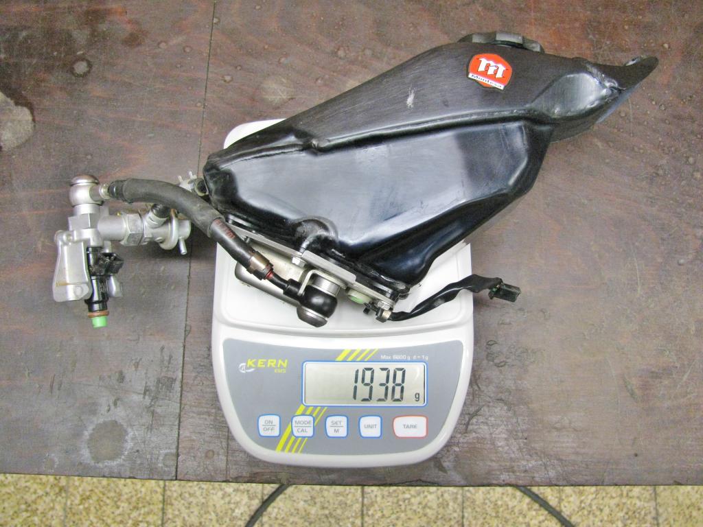

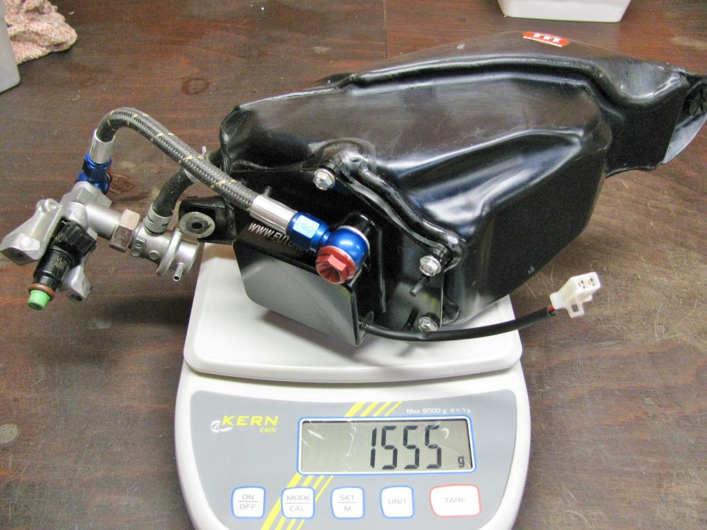

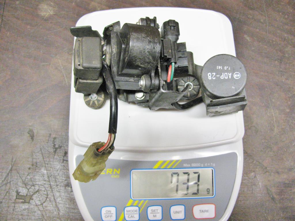

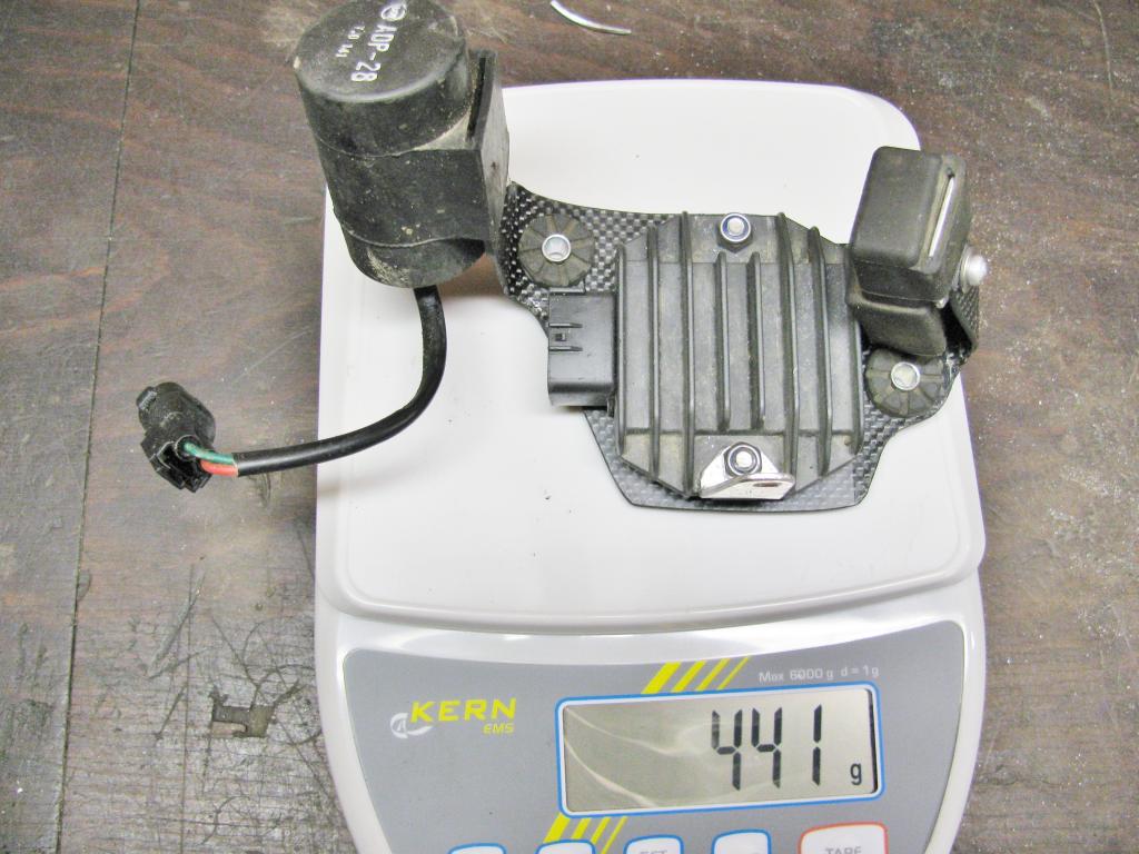

I should mention that the 155 lbs is without the side stand. I'm curious as to what guys 4rt weighs as well as the new rr. Thanks for including the pic. Reminded me to cut the front fender brace.
And thanks to all that have contributed! As far as getting a newer bike goes, ten years ago I said when it breaks or stuff starts going wrong that's what I'd do.
I think I saved about 1,5 kg on that 4RT.
It, as you can see in the picture, had some carbon parts on it and an aluminium fuel tank bottom also.
On the last 4RT Repsol I had I made the electra support out of aluminium.
But weight saving on aluminium parts, like the rear wheel, is minimal. Did the calculation out of curiosity, but forgot it.
But every little bit counts. And tinkering keeps people of the cocaine, I'm the living proof of that.  :stoned:
