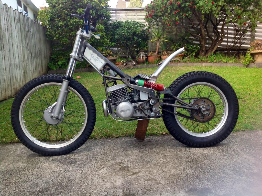

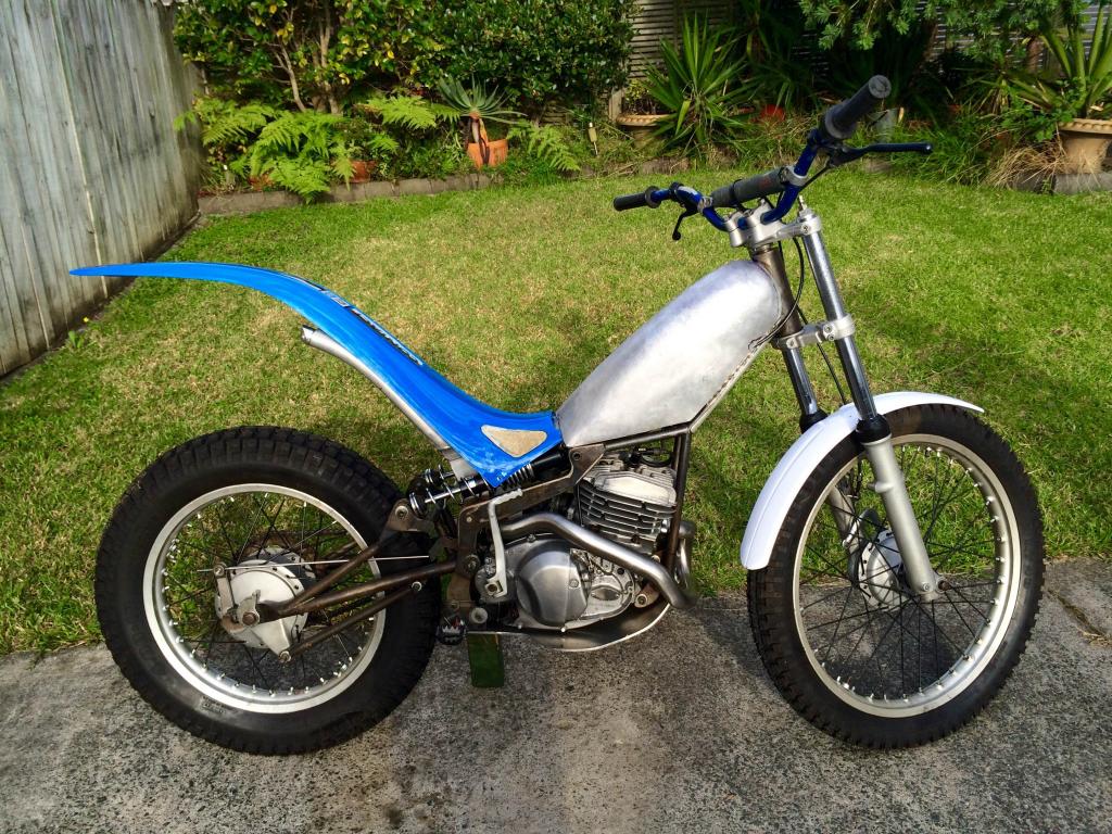

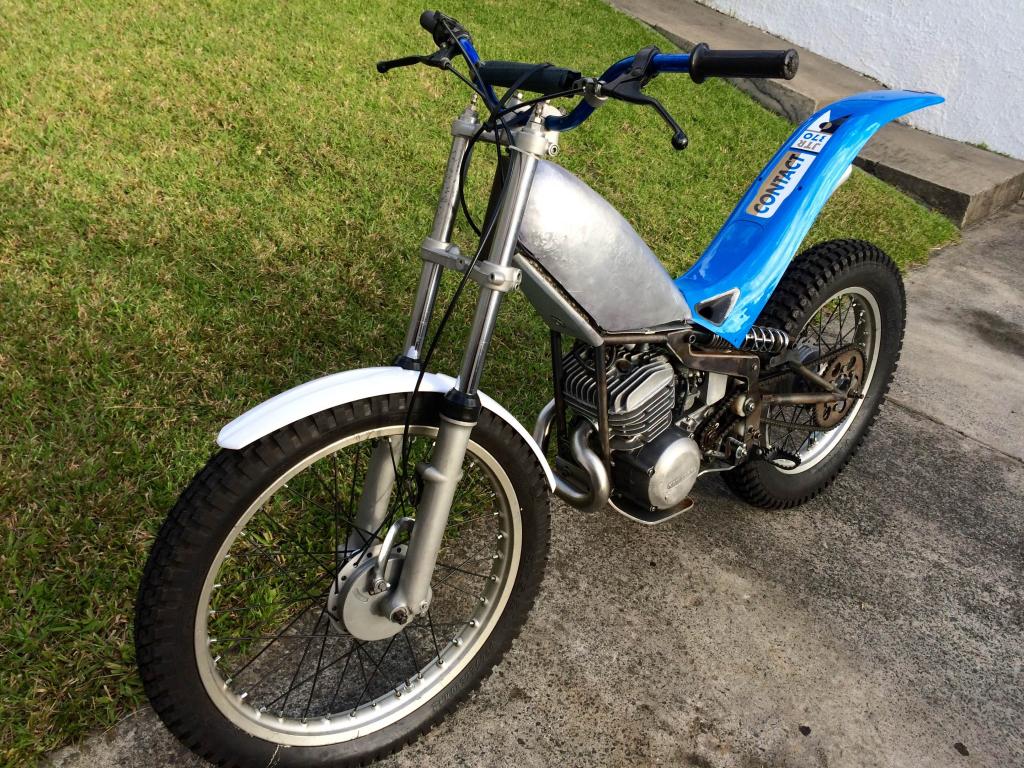

My project KT250r, r for rebuilt, radical, ruined etc you choose
The bottom two pic's are of the first test fitting of the soon to be modified plastics, and the tank before final welding.
Not much to change on the Gasgas guard, what luck!!!
Edited by still trying
To show finished bike
the chain system is my own evil concoction to get around putting the swing arm pivot on the rear engine mount.to move the center of gravity back, without changing the engine casing (cut and weld a block in). I did try to not change any of the original parts, so I can still rebuild an original KT if I wash.
So many interesting features on that KT project. The more you look the more you find. Fascinating!
  • 3 weeks later...
First thing that hit me was the rake. That's a serious angle for a Vintage bike. I love all of it though.
Beautiful work! Lots of thought. Bet the floor around your work area is wore out from just walking around it and staring. Can't wait to see some feedback on how it performs. Will it be done in time for any events this year?
