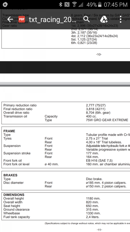

I'm still confused as to why people with modern GG's use ATF? The manual pretty clearly says 75W gear oil...

Yeah, I know, I live in crazytown for actually using the oil spec'd by the manufacturer. It's a lonely world...
