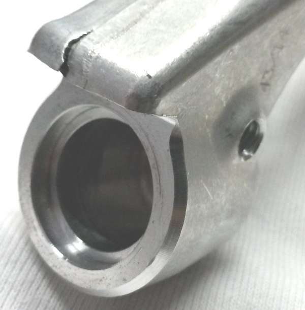

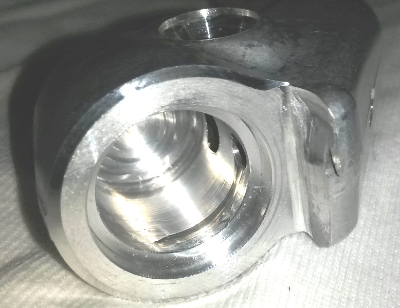

I was wondering if this is common or just a one off.  My less than year old, 2015 4RT has a problem with the kick start lever.  The lug that engages when it's folded out has cracked and deformed.  It seems the alloy is really soft.  Apart from putting the lever at too much angle, I can see this is going to fail in the middle of a ride somewhere.
This bike hasn't had that much use because it's not my only bike.  And other bikes I've owned have never had such a problem even after 10 years of hard use.  And before you suggest it, I am very gentle on the kick starter.  The bike starts better with a slow push than a stab.
I'm happy to purchase a new genuine lever but not if they are all this bad.  Has anyone come across a decent aftermarket lever?

I had this on my 09 and bought one on ebay with same problem .
File of the offending stop, drill and tap and put an M5 (I think) cap head screw in as a stop. If the cap looks like it is wearing replace with a new one.
Sounds like it isn't normal but can happen. I would go with Jimmyl's suggested fix myself. However I would think a new stock lever would be fine.
My 07 is my primary ride and never an issue...
I had the same fault and used the same remedy...on my '98 Cota. :icon_salut:

In any event, I will contact the dealer and send him the photos and see what comes of it.  But I expect I will be doing the fix described by Jimmyl above.  I could also grind it out and build up the lug by TIG welding but that will be even softer than the original.

I know somebody who had theirs welded but not successful.
Mine lasted me a few years and was still good - maybe change the screw once a year.

If you can drill the a pilot hole before the piece break off and even counter bore it so the head of the screw is supported by the original metal is best
