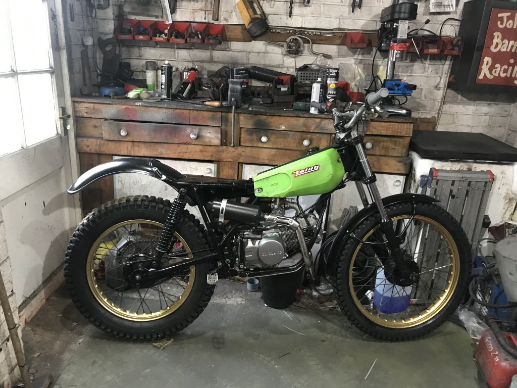

I know it’s been done before ... but an old italjet 100t frame, new 144cc engine ....£600 all in
not a bad result !!

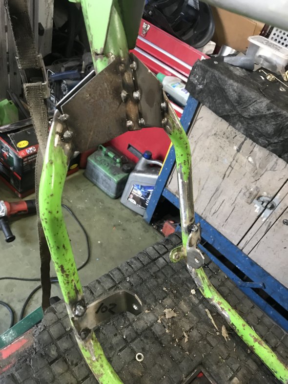

    Hi guys thanks for the replies and comments !  biggest problem on the build was altering the frame to fit the barrel through the frame- I’ve added a pic- but it was relatively easy to cut and f

Cracking job John, looks great can’t wait to see it
Cheers tim
At some point I think chris will ride it in a local trial on easy route.
it sounds better than it looks as well !??
Brilliant, a few lads up here have similar  you're looks the part though.
What's the weel base and it look realy light.

biggest problem on the build was altering the frame to fit the barrel through the frame- I’ve added a pic- but it was relatively easy to cut and fabricate. It’s is a short wheelbase and very light (I’ll check- the bike is at my dads, it’s been his project to keep him busy)- but I guess maybe 2” shorter than modern trials bike and I would say 60ish kg ?.
Because the wheelbase is short we had to move the handlebars forward on the triple clamps, other than fabricating engine mounts and brake pedal, all straightforward ! Just as ever it’s the little bits and pieces that take the time.

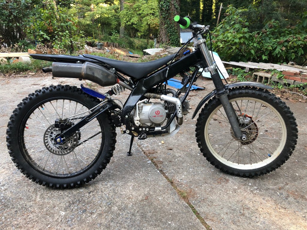

Here's mine, all Chinese except for the Fantic Section forks and KDX200 silencer. Stock exhaust was loud. Footpegs are too far forward for trials but I use it as a trail bike and light trials. Brand new was $1200 from Amazon, no longer available. 180 lbs.
