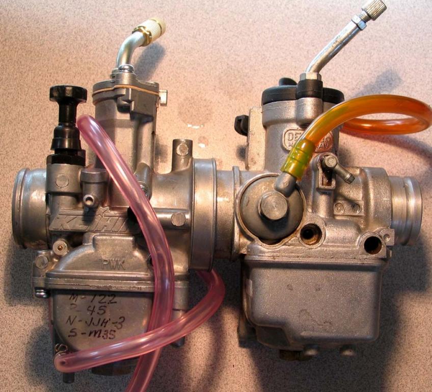

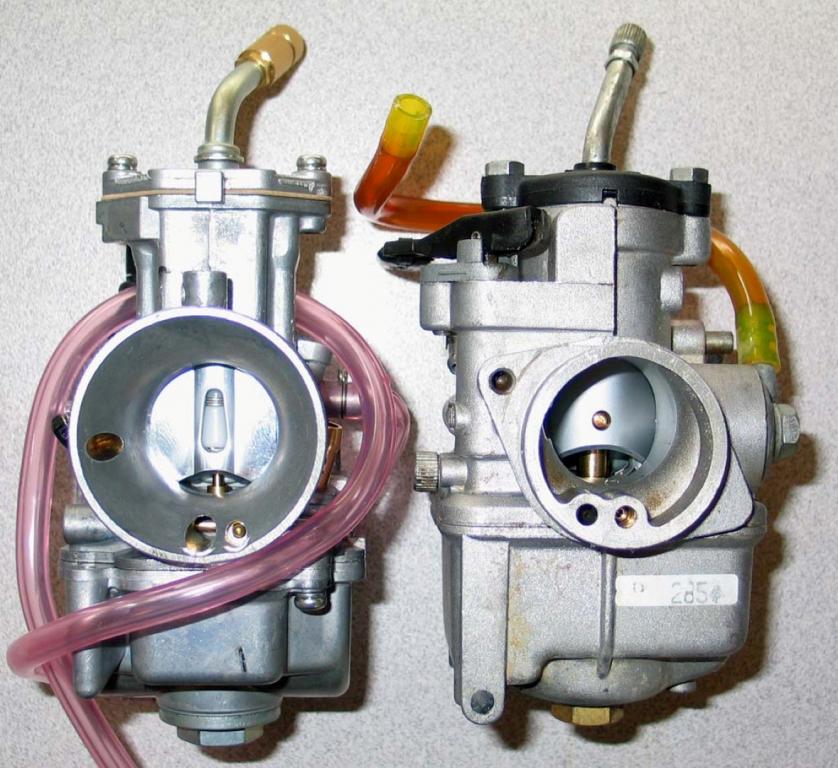

Agree on the carb spacer for the gasser ... best £20 spent on the bike! Makes life so much easier
Those things should be fitted as standard from the factory!
You are OLD, bad knees, bad back, bad wrists!
Call up V-mar! He will make you an extension for your other toy!
yep getting to the older stage of life...........The reason I got the bad knees, bad back and bad wrists is because I still act like I am 18!
Why would I want to have the front forks of my bicycle longer????
I agree. The V-Mar adapter is like the rubber "donut" but a little longer and made from aluminum so you get a more positive seal. The dimensions of the carb/airbox boot area are a compromise in order to fit both the Dellorto and VHST/Keihin carbs. You can see the differences in spigot diameter, bell diameter and body length between the two types of carbs. Not usually a problem except for the confines of a Trials bike. The rubber "donut" adapter on the Dellorto seems just a little too short and flexible in some cases to make a solid, leak-free connection unless you are very careful and deliberate in installing the carb.
I don't have that problem with my 2002 280 Pro as the airbox boot fits the Dellorto perfectly, the adaptation components started in 2003 with the VHST carb used just that one year but also allowed for the Keihin PWK.
Hint: Install the carb/donut/airbox boot junction first and then lever the carb back into the manifold last. If you tighten the carb into the manifold first and then try to get the bell/donut back into the airbox boot, it can be an almost impossible task, in some cases, to get right.
