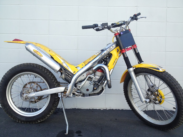

Based on jse comments, got the 2002 Pro chassis for the quicker steering and magnesium engine cases.
Complete rebuild of engine top and bottom end. Installed S3 225cc kit, S3 Stars cylinder head with high-compression insert, and GasGas UK flywheel weight. Rebuilt waterpump, and upgraded clutch to 2006+ specs. Modified FMF Turbine Core 2 from my GasGas EC300 to replace stock silencer and add spark arrester.Replaced Comex radiator fan and Leonelli module.Removed lighting harness and installed kill switch
Revalved Sachs rear shock (2-stage compression and rebound) and changed spring rate. Installed shock upside-down. 4mm preload. Regreased rear linkage and swingarm pivot.
Installed Formula 'Factory' forks with GasGas anodized Ergal triple clamps. Installed ProTaper Hi bend SE handlebars with ProTaper Medium compound grips.
Completed restoration of 1995 JT35. Put a full set of NOS body work and '2-lens' headlight in storage. Replaced Pirelli Gara Trials with Dunlop D803. Installed Renthal handlebars with Renthal Trials grips. Replaced fork fluids, and coolant. Running Maxima 75W transmission oil.
This JT35 may have an interesting history: if built by Jon Stoodley AKA jse for Steve Darrow for the World Championship. Has cylinder head mods, and Keihin PWK carburetor.

Seavoyage like the mods and the bikes . How's the 225 go ? Think that in it's self is a good mod . What difference does the silencer make if any apart from maybe clearing the rear tyre when the shocks compressed?
Ted .
The 225 kit was an excellent upgrade. It feels like a quick reving 250 that spins up quickly with adequate torque but isn't a hand full - which is enough for me.
Since GasGas ceased production of the Pro 200 in 2006; if I had a late model Pro 125, I would install the S3 mods rather than purchase a base 250.
The FMF TC2 silencer definitely scavenges exhaust gas more efficiently as I had to turn in the fuel screw 2.5 turns (leaner), plus it has a very nice deep tone..No 'splooge' with 80:1 pre-mix (synthetic). If you listen to a current GasGas EC250 or YZ250 with the FMF TC2 you'll get an idea on the sound.
anyone know how much those tech forks cost?
I paid USD$1000 after I traded in my original forks (~$200). The price included the Raga triple clamps, steering stem, and front axle. These forks (~5.1 kg.) are much lighter than the stock forks, and with the rebound tuned made lofting the front without power or hopping almost effortless.. It was well worth the cost to balance out the revalved rear shock (the best investment yet) and rear spring. The new suspension makes obstacles so much easier to traverse: hard hits don't deflect or unbalance the bike, and deweighting is almost effortless. It is very compliant yet firm and doesn't bottom out on 4 foot drop-offs.
The bike may not be pretty but it weighs less than a 2013 base model, steers quicker than current models; has a manageable, lightweight motor; and has absolutely brilliant suspension. It cost me less than half the price of a new base model.
Edited by seavoyage
