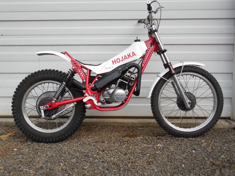

Here is a couple of pictures of my TY175 and 125 Hodaka trials bikes. JKpost-12327-0-24396400-1360820852_thumb.jpgpost-12327-0-03231200-1360820950_thumb.jpgpost-12327-0-16930300-1360820996_thumb.jpgpost-12327-0-30571900-1360821065_thumb.jpg
OK, educate me, what's a Hodaka/ Hojaka and do those rear shocks function at all, they're working through a strange arc?

Erm, I'll try:
The angle of that red meccano sub-frame, where the top of the rear shock attatches; it looks to be too steep for the rear shock to compress as it should, along the axis of the piston shaft?? without too much side load...if that makes sense? :dunce:
Shock angle on the Hojaka is nothin',It's the crazy double steering head on the TY that gets me!
That is just an easy way to change the steering head angle without the need to cut the top and bottom frame tubes.I,ve seen some of his previous builds on the Strictly Hodaka site and they were pretty cool.This is not the first one he has built so I,m guessing that it works pretty good.
Edited by scot taco
Seems a helluva lot harder than cutting the backbone and adding a splice,I have seen it done on XT500 yamahas to convert them for Flattrack,but they've got oil in the frame that would complicate a backbone extension.
I just did a TY175 last weekend,easypeasy,added 1 inch to it.took longer to move the tank mounts back than to extend it.haven't got it reassembled yet,my bud who owns it immeadiately scored another really nice TY and he's been playing with that. I may just talk him outa all the rest of his ty stuff.
